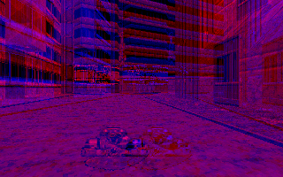

Reply 8 of 12, by rfnagel
Locutus wrote:
I've tried setting screen mode to "7" (RedBlue Stereo), but somehow it doesn't have any effect other than that of the game being reduced to 320x240 now. My game version 1.5. Is there any trick to it?
Per the text file that I attached to one of my previous posts:
Game: "Duke Nukem 3D v1.3D"
Config File: DUKE3D.CFG
Setting: ScreenMode = 7
Comments: Works correctly.
Game: "Duke Nukem 3D v1.4"
Setting: ScreenMode = 6
Game: "Duke Nukem 3D v1.5"
Comments: Red/blue vertical lines on the screen.
In v1.4 and v1.5 of D3D the option is *actually* "6" (even though the CFG still says "7" in the remarks: "7" in actuality for versions 1.4 and 1.5 of the game are for "Crystal Eyes" support; v1.3 is "6" for Crystal Eyes), and unfortunately the red/blue support is totally broken in v1.5 of the game.
P.S. Red/blue glasses support is only in 320x200 resolution.
(edit) P.P.S. Attached screenie of E1M1, D3D v1.4 in red/blue glasses mode. One problem with the red/blue support is that the "convergence" (dunno what else to call it) of the red and blue is too far away <IMHO> (I always had to really cross my eyes in order to see the "3D" effect properly), and is why I think that 3D Realms never promoted (and eventually) canned the feature.
    38.88 KiB
    9345 views
    Duke Nukem 3D, version 1.4, Screenmode=6 (Red/Blue glasses), E1M1
Rich ¥Weeds¥ Nagel
http://www.richnagel.net
Reply 9 of 12, by ChrisR3tro
I managed to get the mode running under v1.5. I am also experiencing strange vertical lines, like described here in the thread. Unfortunately v1.3d crashes on me when trying to set the ScreenMode = 7 (computer reboots). Any Idea why (using S3 ViRGE/DX graphics card)?
for more Retro-related tidbits follow me on X under @ChrisR3tro.
Reply 10 of 12, by rfnagel
Yeah, unfortunately that's a common problem with any of the Build engine games based upon the newer versions of Build (Blood, NAM, Redneck Rampage, etc...).
No idea what would cause that... maybe someone else could jump in here with a suggestion.
BTW, I assume that you're using DOSBox to run Duke? I own the original v1.3d D3D CD as well as the Plutonium Pack CD (I normally run the later, along with the v1.4 to v1.5 upgrade patch... but have the v1.4 EXE in my Duke directory as well; strictly for playing around with the red/blue 3D glasses support), and just did a test install of v1.3d under DOSBox... no problems or crashes on my PC.
Rich ¥Weeds¥ Nagel
