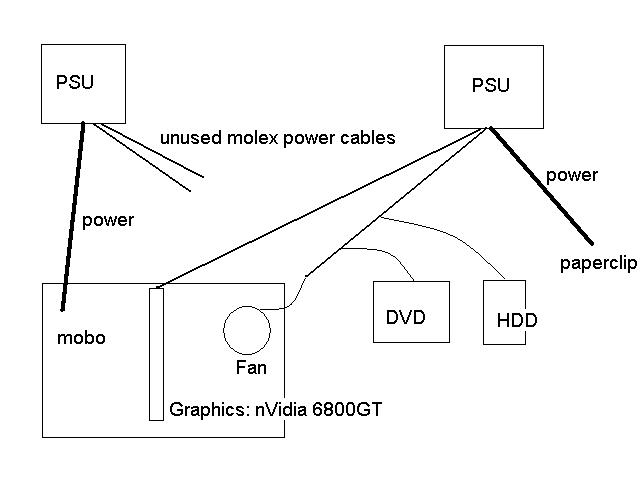

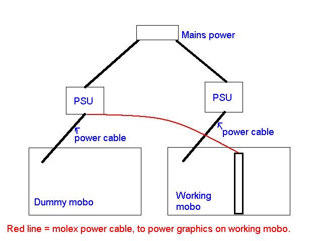

Reply 6 of 31, by retro games 100
I've got a nutty idea! I can't afford a dedicated supplemental PSU ATM, but would this work instead:
Get 2 "normal" PSUs, and plug them both in to 2 mobos. 1 PSU powers a "dummy" mobo which is not used for anything, the other PSU powers the mobo you are actually working on. The "dummy" mobo is simply any old mobo, just to get some "load" on to the "dummy PSU", simply to get it to work. The idea is that you "borrow" most of this PSU's power by plugging in one of its molex power cables in to your working graphics card - which is plugged in to the *other* mobo - the mobo you are actually working with.
    30.2 KiB
    3259 views
Reply 7 of 31, by 5u3
Yes, this is possible, but there are more elegant ways to switch on the "auxiliary" PSU.
ATX PSUs will turn on when you connect the green (PWR_ON) wire to any of the black ground wires. The most simple solution: a bent paper clip. like this:
If you want both PSUs to turn on when you press the power button connected to the mainboard, splice the green wire of the "auxiliary" PSU into the green wire of the "main" PSU.
Reply 8 of 31, by retro games 100
Thanks a lot 5u3! 😀 I must just double-check something: I'm looking at my PSU power plug, and I can see that green wire. I'm looking at this green wire, as if it's on the "top row", as in your photo. Immediately to its left is a single black wire. Immediately underneath that single black wire, on the "bottom row", is a pair of black wires going in to the same "socket". One black wire is slightly thicker than the other. Shall I connect the paperclip from the one and only green wire, to the "bottom row" "double pair" of black wires socket? Thanks.
Reply 10 of 31, by retro games 100
Thanks a lot, this works. I tried a simple set up to begin with: the "aux" PSU is simply providing power for the DVD-ROM drive. That's it. But it works, because I tested it in Windows 98. Now, I'm going to get the "aux" PSU to power a meaty graphics card. In fact, I'm going to try an nVidia 6800GT. The "aux" PSU is a Corsair VX 450W. It has mediocre 3.3 & 5 volt rails (20A each), but it seems to have 33A on its 12v rail. I reckon that ought to power the 6800GT, and if it works, I might be able to get one of the Abit KT7A boards I'm testing to run with either a 2000+ or 2400+ rated CPU, without stability issues.
Reply 11 of 31, by retro games 100
So far, so good. I've got the "aux" PSU providing power for just the nVidia 6800GT graphics card. Everything else is being powered by the other "primary" PSU. I ran 3DMark2001 first edition 4 times, and get these scores:

Following on from the test set up above, I decided to alter the PSUs configuration before rerunning the tests. I did this:
On the mobo, I removed 2 of the 3 chassis/CPU fans.
I removed the HDD power cable from the "mobo PSU"
I removed the DVD-ROM power cable from the "mobo PSU"
Then, I attached 2 case fans to the "graphics PSU", and also attached the HDD & DVD-ROM reader to it as well. (Basically, I'm trying to remove as much strain from the "mobo PSU" as possible. I did think about using a 3rd PSU, just to power the HDD, DVD and fans, but I couldn't be bothered to set that up.)
I rerun 3DMark2001 f.e. and get 8993. I can't be bothered to do another 3 of these tests, so I just max out 3dMark2001 and run that 4 times instead. I get: 7646, 7676, 7664, 7658, (very consistent values!)
I reckon that's a success! Please notice the ~10% loss of speed from the faster 2000+ *133fsb* set up. My final experiment will be to set up the 1.3 revision board, with the 2400+ t-bred, and run it at 133fsb...
