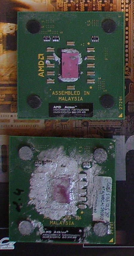

Reply 21 of 31, by ux-3
I am not sure, power is your problem. These old second hand cpus have sometimes been overclocked and overvolted by too much and for too long. Does the die show cracks in the corner?

Reply 23 of 31, by retro games 100
It's difficult to say - generally speaking, it looks in rather poor condition. You know the die has a kind of light pink colour? Well, near the bottom right hand corner (but not right on the edge), it appears that a few tiny flakes/specks of this pink colour are missing - as if it's been scuffed/chipped away. Perhaps it is fractionally damaged in some way?
Reply 24 of 31, by retro games 100
Sorry the photo's not very good. Here are the 2 CPUs. The bottom one in rather shocking condition is actually the one that "works". Hehe!
    74.92 KiB
    1238 views
Reply 25 of 31, by 5u3
Now I see why CPU manufacturers hide their cores beneath metal plates on newer processors... I'm surprised this works at all!
Normally the silvery thermal paste is not really conductive, but on both CPUs it is in places where it doesn't belong. I'm afraid there is no easy way to get rid of it, but soaking the whole CPU in something might be worth a try.

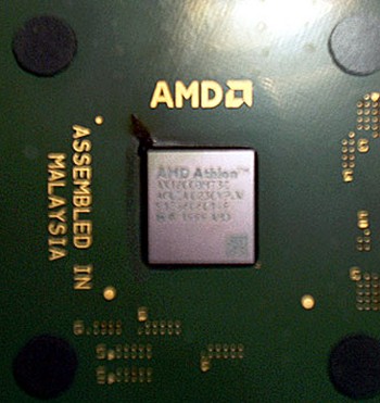

h-a-l-9000 wrote:
Remembers me of this website 😁
http://www.dau-alarm.de/g_cpu4.html
Bushwack, I've copied-and-pasted one of the photos from the above website. Do you remember I described one of my "smoked" CPUs as having "black goo" in the corner of the die. It was a bit like this photo, although not nearly as bad!

Reply 28 of 31, by Amigaz
Have had some cpu's that were drenched in thermal compound like this.
I get the job done cleaning rhem with this (no rocket science)
It easily disolves different variants of thermal compound

Reply 29 of 31, by retro games 100
So am I. But I just retested it, inside a Kinetiz KT133A based board. Surprisingly, it works fine - at "top speed": 2000mhz / 133fsb.
