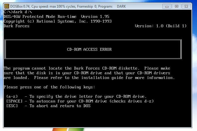

🙁 I've tried a few different ways, but I just can't get this game to run. Using DosBox v0.74 on my 7 Pro. 64Bit system. Can anyone give me some help please.

Reply 4 of 15, by Corey
bloodbat, this is what I tried:
1. Mount c d:\
2. C:\
3. Install
4. dir to install to
Then I get errors stating sounds.gob & other files cannot copy to my selected dir.
So then what I did was:
1. Copy the CD-Rom's files to my desktop
2. Install
3. Dir to install to
4. Dark D:\
Then I get the screen you see below:
How did you get the game working correctly? The sounds are coming through just fine when tested after install & I have the AMD Athlon X3 435
    64.85 KiB
    3975 views

Reply 6 of 15, by bloodbat
What you said is kind of vague...but as Qbix said, read the guide it WILL help you...what I can gather from what you said, you aren't mounting both a HDD and a CD
ie:
mount c c:\dosgames
mount d d:\ -t cdrom
You'll need both (a harddrive and a cd)...otherwise it won't work and you'll get such errors...since...it's trying to write to the cd...ROM.
Bloodbat
Reply 7 of 15, by Corey
😐 Thanks for the help & link. I finally had time to read & apply the guide, worked just fine. Dark Forces is working no prob. so far & I'm happy for that.
