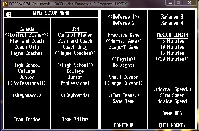

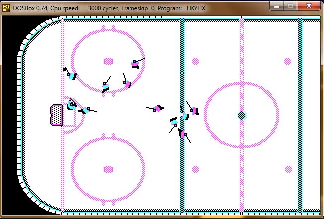

Hi all,
I managed to get Waye Gretzky Hockey 2 running with the hkyfix.com created by Peter Ferrie.
Unfortunately this does not look like the game I know from my youth.
Graphic is CGA (see attached screenshots) and I am missing stuff like changing jersey colors.
Even Gretzky Hockey 1 looks way better!
Is anybody playing this game and got it running correctly?
Do I have to change some settings in dosbox (I use 0.74)?
Any help welcome, thanks a lot.
Joachim
btw. has anyone got a manual for the pass codes? (I already guessed 2 of them, but it would be easier with a manual)

Besides telling you the answer to the copy protection question, the manual also tells you the game's command line parameters:
-c (CGA, default)
-e (EGA)
-t (Tandy)
-fvd1 (if Fight Video Disk 1 is installed)
-adlib
-sblaster
Note that the SB sound has some annoying pops; too much DC offset in certain samples.
@DOSBox devs: this game will work without needing any kind of fix with the cputype=386_prefetch setting if INT 2 and INT 3 don't have the same segment. It's anti-debugger weirdness in the game's encryption wrapper. The game also wants INT 1 and INT 3 to point at an IRET; however, instead of crashing or aborting if the vectors don't point at an IRET, it just looks for an IRET in the BIOS ROM segment and then points them there. ;)

-e was the solution.
thanks a lot!
