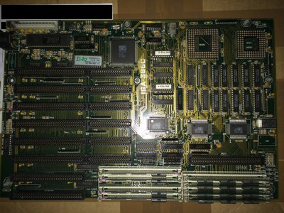

Do you have Cache Memory on your Mainboard ?

edit: sorry, forgot about your cache memory question. i'm not sure, i think so, i've attached an image of the mainboard.
472.81 KiB
625 views
edit2: during boot it says "64KB cache memory"
