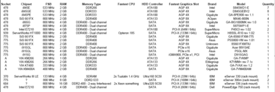

I have attached a specification list of the P4 motherboards collected from the company lot. Unfortunately, the socket 939 is without a CPU. Everything else has a CPU. Aside from the rack mount systems, it sounds like the dual channel DDR400 boards are the best to form a web browser box out of. These correspond to the Intel 865G, 875P, 915G, 915GL, E7210, and ServerWorks 1000HT chipsets. I am fairly CPU illiterate beyond a Pentium III. What are the fastest possible CPUs I can use in these systems?
For the i915 boards, the Acer/Gigabyte 8I915AE is limited to 2 GB, which makes the Asus P5GL-MX more appealing with a 4 GB limit and PCIe x16. The 3rd i915G board is an Intel D915GAG, however the PCIe x16 slot was never soldered on. It has only a PCIe x1 slot, 2 PCI slots, and an onboard Intel GMA900. Is the Intel GMA900 any good, or is a PCIe x1 graphics card preferred in such situation?
For the i865G (Gigabyte 8IG1000MK) and i875P (Intel S875WP1-E) boards, both are AGP 8x and support 4 GB, so does one platform support faster CPUs than the other? Are the i865/875 considered faster or more stable than the i915?
Lastly, there are two PCI-X boards, which I am hoping will function with the only PCI-X card I know of, the Parhelia 256. It would be fun to setup a system just to be able to use a PCI-X graphics card. I already have the graphics card. One board is based on the Intel E7210 and the other the ServerWorks HT1000, which I have presumed the Opteron 185/190 is the fastest available CPU. What is the best CPU for the E7210?
Based on your responses, it seems that the rest of the boards are junk - i845, SiS 661FX, and VIA KM266/KM400/KT400 and probably of limited collection interest in the coming decades. I didn't realise SiS was still making chipsets. Was the 661FX not well received?
