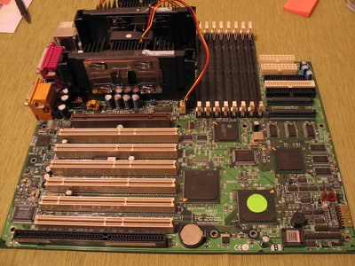

4GB in anything with a 440BX or 440GX chipset is plainly impossible, the memory controller just isn't up to the task. However, if all you want is a lot of RAM with a Slot 1 system, your only logical choice is a Tyan Thunder 2500:
http://www.tyan.com/archive/products/html/thunder2500.html
732.66 KiB
3524 views
Serverworks HE chipset, 133FSB, Dual Slot 1, 8 DIMM slots supporting 8GB of RAM (Fully Addressable with a PAE-Aware OS), SDRAM interleaving giving near DDR levels of memory bandwidth, 64-bit PCI and 66mhz PCI slots, onboard SCSI, onboard Intel 10/100 LAN, onboard SB-compatible Ensoniq audio, 3.3/1.5v AGP Pro slot, and an ISA slot just for good measure. Its only downsides are that the board is a bit flaky without the right hardware, AGP performance on Serverworks chipsets is frankly god awful, and no one has ever attempted to run Tualatins on it. Also, its rare, very nearly as rare as the Supermicro P6DGH or the Asus P/I P65UP8, you're best off scavenging them from old SGI Zx10 Workstation systems if you want to find one.
