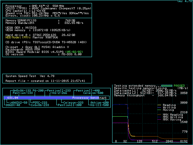

More like how much faster really is the K6-3 compared to the K6-2 when the K6-2 is used on an Alladin V "G" Revision.
And I have some preliminary data (K6-2 500 @ 550, Asus P5A Revision 1.06):
7.34 KiB
1324 views
Phil, I have my test rig set up. Can you please advise me on the best method of running benchmarks to compare against your results?
edit: Ok, it's not looking so good for the K6-2 so far. For PCPBENCH /VGAMODE I got an almost identical result (134.3) to yours (134.6). But as expected, I did NOT get that enormous decrease in performance with more than 128MB of RAM. So the Revision G is indeed caching all the RAM.
So the preliminary result shows that the on-die cache does indeed give an appreciable boost to the K6-3 in integer apps. I'm curious to see K6-3 scores in Speedsys compared to my K6-2. I'd also like to do some 3D benchmarks, but I haven't got a Voodoo 3 3500. I Right now I have a GeForce FX 5700LE in the board, and I've got a few other cards (Radeon 9700, GeForce 4 MX 420, TNT2 M64, GeForce 2 GTS, etc...)
