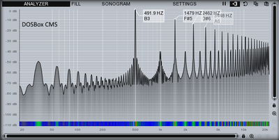

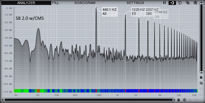

Reply 28 of 32, by James-F
Using the CMS440 software by Jepael that generates a 440Hz signal, I we can test the CMS frequency.
DOSBox CMS frequency emulation is FAR from being accurate.
The real CMS generates a 440Hz signal, distorted but frequency accurate, as it should.
DOSBox generates 492Hz signal when it should be 440Hz, so something is definitely off in the emulation.
People fuss about 1Hz when comparing YMF289 vs YMF262 OPL3 chips but this is not a 1Hz difference, this is a huge clearly audible difference, a completely different pitch/note.
This is true as of the latest SNV 3995 of this date.
Real SB 2.0 with CMS by Jo22:

DOSBox CMS:
