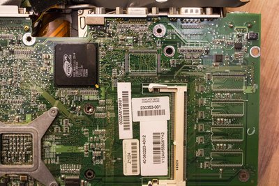

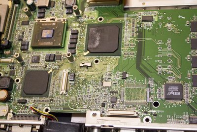

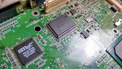

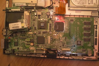

That machine has only 8MB of VRAM, but is capable of 16MB (model 1800T). Textures are sometimes bugged because of lacking memory. This laptop performs almost as good as desktop PC, for example Half Life was totally smooth (looked like 60 fps, but I didn't measure) in all resolutions up to native 1024x768, but in higher resolutions problems with textures are starting. GTA 3 is almost playable with a hack that removes memory check.
I would like to add another 8MB, so the performance would be better. I disassembled that notebook in order to replace RTC and made some photos of both sides of mainboard. Two TQFP soldering pads are clearly visible, they are empty but you can see that there are memory chips soldered in 1800T models (picture: http://www.benchtest.com/images/18-8.jpg). So I was wondering if I could just solder the addidional memory. Do you think that it would start working immediately? That ATi RAGE Mobility 128-M chip apparently has 8MB on-chip memory + the ability to use external memory (it doesn't use system memory, it's all dedicated).
Or is there a chance that it would end up in a total catastrophe? 😜 I could buy just the new mainboard, but the shipping to my country would be expensive (and I can't find anything locally).

Worth a try but be warned it will likely brick the board or simply not be recognized so I strongly suggest that you only do this on a spare board if you can get one.
Reply 4 of 6, by matze79
I think you have to change a few resistors too, if you add video memory.

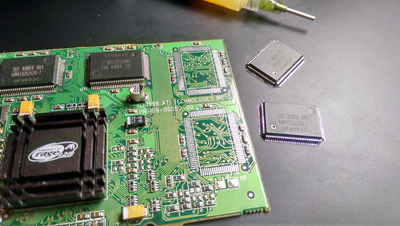

All right, after waiting several years i finally did the mod 😁
i just desoldered two 4-megabyte chips off Rage 128 Pro AGP card (KM4132G1120-7) with hot air and soldered them to the mainboard. Extra memory was instantly recognized on the notebook, nothing else was necessary 😀

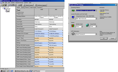

3dmark99 score is now 27% better with 16MB.
