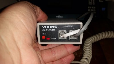

Well, I managed to snag one of those Viking phone line simulators off eBay for a good price, and it arrived today.
1.43 MiB
3260 views
Viking Box

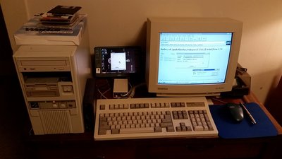

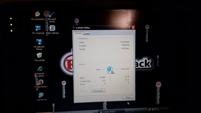

My Fujitsu C500 tablet has both a modem and wifi, so I set it up as a dial-up server and connected the two computers together using the Viking box.
1.32 MiB
3260 views
Entire Setup

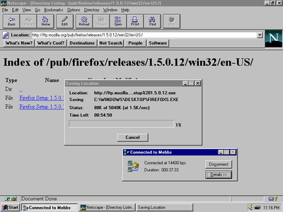

The 486 dialed, and the tablet answered.
736.46 KiB
3260 views
Tablet Server
Success! My own working dial-up internet server for my vintage computers!
20.1 KiB
3260 views
Working Dialup
Now to wait the several millennia or so it'll take to download Firefox... 🤣
It's not 100% perfect though. Every now and then it does like to randomly disconnect, but I don't know if this is the Viking box or the tablet causing the dropped connections. Something I'll just have to keep an eye on.
