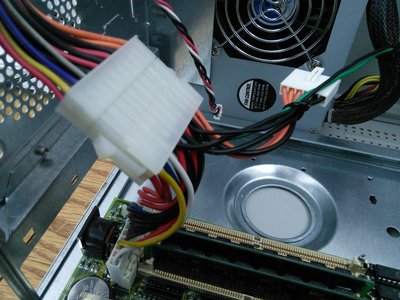

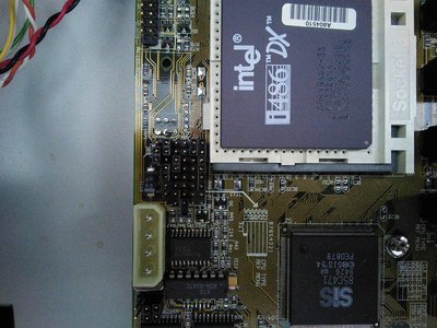

OK, connected the speaker and switched the CPU. Same thing PSU fan spins, no video output and no sounds from speaker. I am using an adapter to adapt the ATX PSU to the AT board. I tried a few different ATX PSUs and no go. Maybe there is something wrong with the adapter and the way it is receiving power? I wish I had an AT PSU to try.

I am testing with an ATX PSU + adapter, works fine so I don't think that's the problem.
However, by looking at your jumper settings I noticed the following differences with mine:
- JP23: you have 3-4, 5-6, 7-8, according to the DX/DX2 section on the manual it should be only 5-6, 7-8
- JP24: looks fine (7-8)
- JP25: looks fine (open)
- JP26: you have 1-2, 5-6, it should be open
- JP27: you have 4-5, 7-8, it should be only 7-8
- JP13: you have 1-2, it should be open
Please give these settings a try as they work well for me with DX/DX2 processors. Also make sure you have both JP9, JP10, JP18 and JP19 set to 1-2 (DX/DX2, 0 VESA Wait States, <= 33MHz CPU bus).

I'm not home right now so no access to the board, however I have marked in your picture the pins that you need to jumper for JP23-27 + JP13. You only need those 4 jumpers marked in red in that section.

The other components (CPU, VGA, memory) are known to be working right? Here's a couple of things I would check if the board shows no signs of life:
- JP6 (near the battery). This jumper should be in 1-2 position for normal operation. Otherwise it's in clear CMOS mode and the board may fail to POST
- No jumpers on JP7 or JP8 (also near the battery)
- JP9 and JP10 jumpers should both be in 1-2 position (these jumpers are located between the SIS chip and the BIOS)
- JP18 and JP19 also should be in 1-2 (between 2 VESA slots)

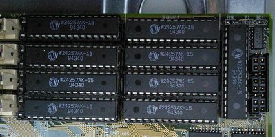

- You could also check the cache jumpers, depending on how much cache you have installed
If you have trouble identifying the pin numbers, remember that pin 1 is marked with a small white stripe next to it on this board.

I have no way of testing the components to see if they are working really. All the jumpers are set as you indicated. Not sure about the cache. I think it has 256kb cache. Here is what it looks like:

Yeah, cache config looks good. Sadly I don't know what else you could check other than the obvious (inspect the board for physical damage, missing components, and so on). Perhaps someone skilled at electronics can suggest something?
