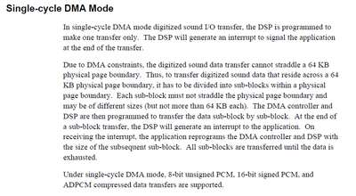

Reply 46 of 65, by James-F
Thanks you for these recordings firage!
Yes, the CT2940 also rings but more faintly than the CT2890.
As I thought, the DMA clicking and Ringing problem are actually related and only happen with single-cycle DMA sounds.
The SB16 cards that click, do not ring.
The SB16 cards that ring, do not click.
It seems that residual ringing is heard because the DSP does not mute the signal and keeps the audio channel open.
The click is actually a closing of the channel as it should be, but it is not silent.
Now it is official, there is NO bug free SB16 and I'm not talking about MPU-401.
This is my personal opinion, if you don't need 16-bit sound in DOS games (hardly), I would stay away from the SB16 altogether, it is a really bad egg.
If you need 16bit sound in Windows 9x, there are MUCH better ISA cards than the SB16.
But if you must have one, I can say the CT2940 with YMF289 OPL is the most acceptable SB16 card if you find one.

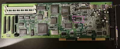

Reply 52 of 65, by HanJammer
James-F wrote:
(...) CT1703-T is the noisy DAC appearing only the CT2230 (19413) and (29417) but not on the CT2290, also on the first revision […]
CT1703-T is the noisy DAC appearing only the CT2230 (19413) and (29417) but not on the CT2290, also on the first revision AWE32 CT2760.
CT1701 is the oldest and noisiest appearing on the first SB16 CT1740 cards.
The early AWE32 CT2760 which came in 1994 use the noisy CT1703-T DAC.
Later AWE32 had the quiet CT1703-A but also omitted the real OPL3 chip.
My CT2760 has CT1701-T. And what now? ;]

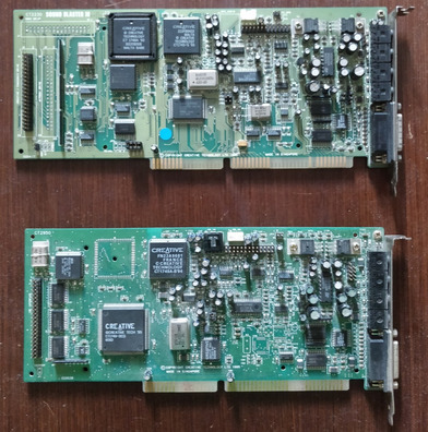

Hello all
You can see that I have two sb16's (one CT 2230 with asp chip and one CT 2950).
As you all guys are more experienced than me which one should I use for a better sound and music ?
    386.79 KiB
    2068 views
Reply 54 of 65, by bloodem
The image quality is quite poor, so it's hard to see some specific details, but the first card, the CT2230, is definitely the better option. It has real OPL3, whereas the CT2250 seems to lack the Yamaha YMF262 chip (which means that the CT2950 is probably the CQM version). The 2950 has both the Type 1 & 2 MPU-401 hanging note bugs, so MIDI playback will be an issue with many games (if you are interested in that). Also, a bit harder to tell from your picture, but the DSP chip on the CT2230 seems to be either the CT1703-A or the CT1703-T. If it's the "-A" version, it's one of the better, quieter cards. If it's the "-T" version, it will be quite noisy.

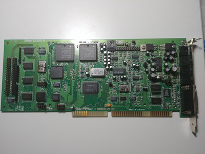

Reply 57 of 65, by cde
Thanks for the review. I have received a similar card, the CT2290 and found it to be excellent;
- line out with extremely low noise, even with volume at maximum
- does not pick out the electric noise from the CPU activity unlike my CT1750
- CT1741 DSP 4.13 without hanging note bug, functional WaveBlaster header
- modern CD-IN connector, again unlike the CT1750 (it does not block the DreamBlaster X2 which works fine)
- ASP chip
- real OPL3 (CT1747 clone)
- not speed sensitive (works with Athlon XP)
Overall it seems to be a great choice for a SB16. Also see: https://sites.google.com/site/soundcardcomparison/
