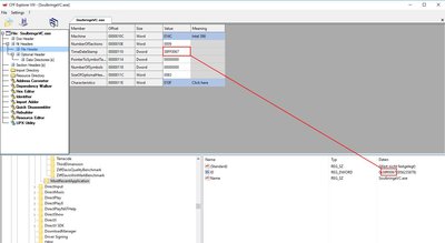

Reply 2895 of 3949, by teleguy
VirtuaIceMan wrote:
Baku a colour hack would be fine I think, it's ancient! I found this site, but I can't get Baku to appear in the most recent apps list in the Registry: https://www.neowin.net/forum/topic/927140-win … mment-593322376
It doesn't have to show up in the recent apps list, you can get the id from the exe itself.
The attachment game-id.jpg is no longer available
This tool does it automatically:
http://www.bitpatch.com/downloads/ddraw_color_fixer.zip

Reply 2897 of 3949, by UCyborg
teleguy wrote:
HKEY_CURRENT_USER\SOFTWARE\Classes\VirtualStore\MACHINE\SOFTWARE\Microsoft\DirectDraw\MostRecentApplication
HKEY_CURRENT_USER\SOFTWARE\Classes\VirtualStore\MACHINE\SOFTWARE\WOW6432Node\Microsoft\DirectDraw\MostRecentApplication
It redirects here when run as regular user.
