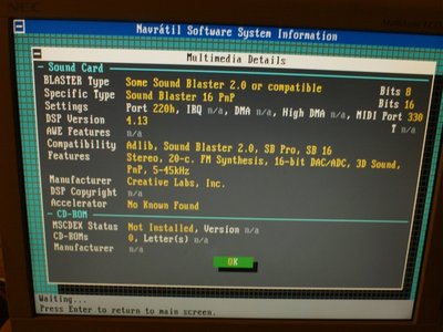

c) Run NSSI and let it detect the sound card.
You can get it here: http://www.navsoft.cz/products.htm
Note: You may have to unload shells like Norton Commander (ncsmall) before running it,
because NSSI is a bit paranoid and mistankenly believes there's a memory-resident debugger active. 😁
Edit: Your card has got a crystal codec (cs4231-kl), just like the Gravis Ultrasound MAX!
So it is apparently Sound Blaster Pro 2 and also WSS compatible.
http://www.amoretro.de/2012/06/gravis-ultraso … ax-rev-1-8.html (English translation)
    369.12 KiB
    1490 views
    NSSI detected my SB16..
