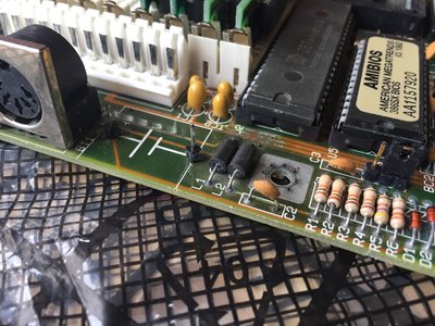

I can't find much info on the board, which seems to be a generic 'made in China' model from circa 1992. I did find something almost identical on eBay which was labelled as an 'ML765 V3', and has 'Firenze Research Lab' as the manufacturer. Mine has no such markings. The graphics card looks to be an Acumos AVGA1.
Unfortunately the board has suffered battery leakage while in storage, which had damaged one of the tracks to the keyboard socket. I was able to clean things up with the usual vinegar/water/IPA process, and repair the track damage with a wire. The keyboard BIOS socket had also been damaged on one pin, which I was able to fix with a small piece of metal.
Currently the system will boot from floppy and I can access the AMI bios, but any attempt to boot from hard disk (using either the IDE port or the WD MFM controller) meets with an 'HDD Controller failure' error message. Think I need to try all the various permutations of expansion slots as there are no address jumpers on my IDE controller card.
The other weird thing is that the RAM shows up as 3840K when all 4mb is installed. Also cannot seem to get the machine to recognise any more than 4mb, although the only other 30pin SIMMS I own are 2x256k so it's not like that's a big deal.
Am hoping that the above issues aren't due to battery damage to any internal layers of the board.

Welcome to the forum.
Starting with the motherboard, it was manufactured by Micro Leader Enterprises.
Check here if you can perhaps find your motherboard: http://arvutimuuseum.ee/th99/#1 (look under 386 motherboards for a schematic that is similar to yours).
This will help you with memory installation and what the motherboard supports.

That link is a great resource, but unfortunately I can't seem to find a similar schematic with the two bios chips between the ISA slots and the 8 SIMM slots.

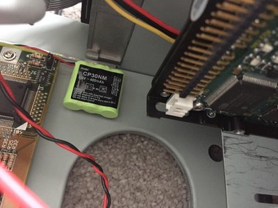

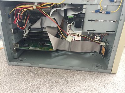

Reply 13 of 25, by Andy1979
Almost finished now. Soldered pins in place of the CMOS battery and mounted a 3.6V NiMH pack from a cordless phone safely away from the motherboard using sticky velcro. Seems to be keeping time and remembering the BIOS settings after leaving it on for a day to charge up, which is good as the battery was only reading 0.3V when it arrived.

CF card is also mounted and working. Left the older MFM and IDE drives in situ in case I ever want to use them. Also installed a 3Com network card.

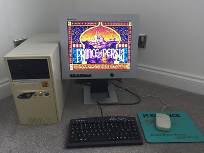

Should have a more suitable keyboard somewhere, though when I get my other retro machines up and running am planning to use my old Microsoft Natural Keyboard Elite. Now it's time to play some games! Last job will be to install a sound card when I find something appropriate.

Nice rig! What are those yellow ground(?) wires going to the floppy screws and I/O cover screw for?

The yellow wires were installed by the system builder who supplied my Pentium system in 1996 (where the case came from), so I left them in. Assume they are for grounding as you suggest. They were quite thorough - all of the drive connectors had also been fixed in place with a glue gun, in a way that they could still be removed for upgrades.
