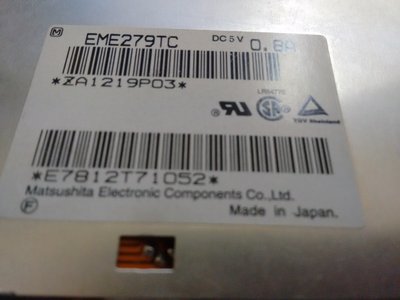

Drive has the following markings on it:
EME279TC DC 5V 0.8A
ZA1219PO3 (or is it ZA1219P03?)
LR84776
E7812T71052
Matsushita Electronic Components Co., Ltd.
Made in Japan
If anyone knows anything about the drive's connector or how I could get a replacement it'd really help.

Here's what the label on the drive looks like.

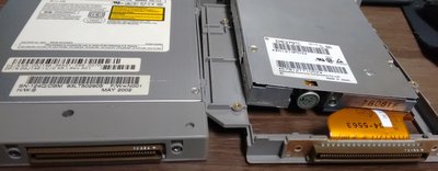

The broken drive from my laptop is on the bottom, and a drive I pulled from a Dell is on the top, you can see the connector's slightly different.

No floppy drive was ever manufactured with this connector and without this flaw? There's no converter out there that can allow me to use a normal floppy drive? Pretty serious weakness indeed.
Reply 6 of 15, by senrew
These connectors were all proprietary to the maker. I have a stack of 4 toshiba external floppies for my 480cdt, but the external floppy connector is dead. Fun part is, these particular drives are NOT the swappable ones that can go into the multi-bay in place of the CD drive so they are useless for me at the moment. The specific floppy drive model that can be swapped in is completely different and it's almost impossible to find documentation on it on the web these days. I only figured it out by dumb luck and sketchy link travels.

Yeah, the internal connector on the floppy drive, once you get it down to the bare drive itself, is completely unique. That drive, that slides out of the external case, can be used only with that external case. There is another floppy drive model that can be used either as an external or slipped into the multi bay in place of the CD drive. I have yet to find one of those in working condition.

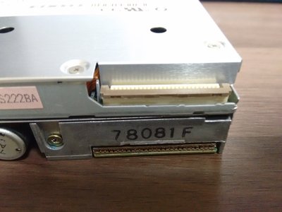

Mine is the one that can be put in place of the CD drive. Here's a picture of it partially assembled, next to my CD drive. Notice they have the same connector.
1018.6 KiB
2808 views
CD drive and partially assembled floppy
(Assuming it worked) I could just pop it in place of the CD drive and use it as if it was a laptop that had a floppy and no CD.
(I'm assuming you wouldn't want it because it's broken, but if you did maybe we could work something out? I don't care about being able to put it in the internal bay, I just want to be able to read floppies or something that acts like floppies. (External storage I can boot from.))

On the subject of suitable replacements, it turns out the drive's connector, right down to the damn internal one, are Toshiba proprietary, meaning only other drives from Toshiba laptops can possibly work. As noted above, the damn things are all ticking time bombs. (And this is in contrast to the CD drive, which is standard slim IDE!!)
It doesn't seem like the connector has any documentation available, or been reverse engineered or anything either, meaning no converter to a normal floppy drive could exist.
