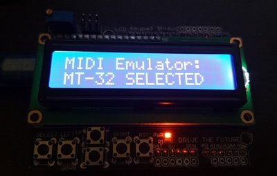

So I took a few hours and learned enough Arduino programming to make this happen.
First I bought this cheap Arduino clone with a 2x16 LCD display and buttons.

Once you're happy with the changes, go to Tools -> Ports and make sure that thecorrect COM port is selected. click Verify and then Upload.
The LCD screen should show some text and the Up and Down buttons should scroll through the emulators list.
If you're not seeing text, try to turn the contrast knob on the top left corner with a small screwdriver.
Use the Select button to select the emulator. It should blink and show "SELECTED".

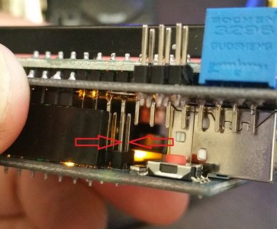

You may have noticed that although the LCD and the buttons work, nothing is happening on the computer. This is because we havn't flashed the keyboard firmware yet. So:
While the board is plugged to the computer, we need to short the RESET and GND pins:
89.8 KiB
566 views
With the LCD on top of the board, it is a bit tricky to get to the pins:
101.31 KiB
566 views
I used a small wire I had laying around, but you could use a screwdriver or whatever.
Once the pins are short, the board will switch to Device Firmware Update (DFU) mode.

Now, finally, select the desired emulator from the list, press Select, and hopefully the desired emulator will pop up.
I really hope that you'll find the guide useful and give this a try.
I had fun doing it, even though I'm sure that any half decent C programmer will faint at the look of my code 😀
