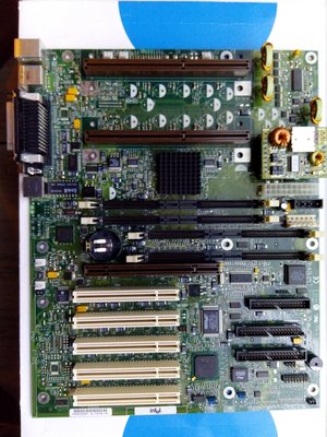

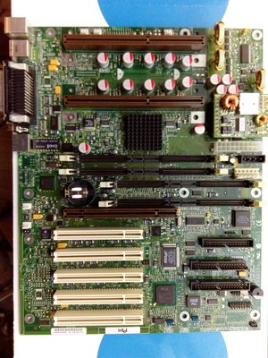

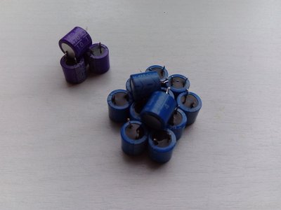

A recap after all…
I recently started a new project and one of the first things to do was recap the whole motherboard. Since I needed to add some extra dollars to the order to get free shipping from mouser (recommended, btw, super-fast shipping and delivery), I figured I'd order new caps for this board. Behold,
The old Sanyo OS-CON caps. They were still in good shape so I'll save them.
2.62 MiB
2913 views
The OR840, mid-surgery.
2.38 MiB
2913 views
The new bling: Nichicon organic polymer capacitors with even LOWER ESR than the OS-CONs
3.54 MiB
2913 views
I'll test it out and report back.

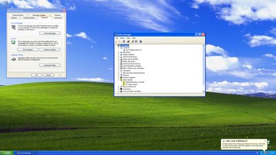

ACPI Woes
In a previous post I had mentioned some trouble when trying to install the ACPI HAL under Windows XP: a normal installation would recognize the computer as an MPS Multiprocessor PC, and trying to force the ACPI HAL during installation by pressing F5 before the F6 extra drivers prompt at the beginning would result in an unbootable system. This frustrated me so I installed Windows 2000 Pro and have been happily running it for quite a while now, but the other day I got curious as to why Windows 2000, Linux, and Windows 98/ME recognize the machine as ACPI capable, but Windows XP refuses to do so.
With Windows XP Microsoft put its foot down and decided that only ACPI 2.0 capable machines would be allowed to run the ACPI HAL, as a way to pressure board makers into the new standard. The way Windows XP decides what constitutes an "ACPI 2.0 capable machine" is not straightforward at all, though. Basically, if the BIOS in question is dated 1999-01-01 or later and it is not in the [NWACL] list in the i386/txtsetup.sif file—the "bad BIOS list" for short—then it gets to use the ACPI HAL. If the machine's BIOS is dated before 1999-01-01 but is on the [GoodACPIBios] list in the aforementioned file, it gets to use the ACPI HAL. And finally, if the BIOS came later than 1999-01-01 but is on the "bad BIOS list" it gets no ACPI… Guess in which list is the OR840?
Yup, bad BIOS list, along with other pretty nice boards like ABIT's BP6 and ASUS' P2B-D. Here's the full "bad BIOS list" from the official XP Pro SP3 CD downloaded from Microsoft's site;

As far as I understand, attempting a Windows XP install in any of these will result in the machine using any of the non-ACPI HALs. If you try to force the HAL with F5 during installation, I can only speak as to what happens with the OR840: it will not boot. There is another way to force ACPI though, modify the option ACPIEnable = 2 to ACPIEnable = 1 under the [ACPIOptions] header of the aforementioned file. This will allow the installer to probe for ACPI compatible BIOS and install the proper HAL independent of what the "bad BIOS list" says. So, the good news is this behavior can be changed, but would you want to? Motherboards get put in the "bad BIOS list" due to instabilities, as tested by Microsoft. So what to do?
419.34 KiB
2832 views
Well, I risked it based on a hunch: the OR840 is listed as IntelOR84009/14/99, and according to some google-fu and with the help of the internet archive, I realized that the BIOS versions at that date were the very first available for the board: 0127.P01, 0128.P01, or 0129.P01. The last BIOS version available for the machine is 0255.P04, released in 2001. During the various BIOS revisions, S3 states were added and removed, and my hope is that any ACPI malfunction was ironed out enough to run the system stably.
I'll report on this after some time has passed.

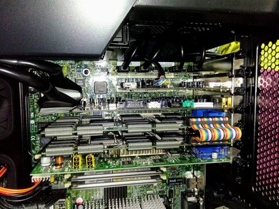

Reply 72 of 269, by slivercr
Follow-up on the previous follow-ups
RDRAM troubles: the end?
So, I don't want to jinx it, but it seems the motherboard was just dirty.
After my last update I took apart the machine and proceeded to clean the motherboard very thoroughly. And I mean VERY thoroughly: IPA, toothbrush, toothpicks, cotton swabs, compressed air,… the complete package. The idea was to leave it clean so that during the weekend—today—I could look at it to try to figure out what's wrong. Half-way through the process I found myself in the densely populated area near the three power connectors and the top RDRAM slots. There's an IC and an electrolytic capacitor there. To my surprise there was some caked stuff near the IC (which is a clockgen for the RDRAM, btw EDIT 2018-02-18: the IC is marked LVC32A, a quadruple, 2 input positive OR gate. The clockgens for the RDRAM are located under the bottom Slot1 connector, on either side of the i840 chipset.): my guess is leaked substance from the electrolytic cap there, which I failed to notice and clean when I replaced that capacitor…
12.01 KiB
2688 views
In any case, I removed the stuff, cleaned the rest of the board pretty well and out of curiosity set up the components on my test bench, i.e. an empty motherboard box. After a solid POST and quick Windows boot the machine has been running with 2 GB of RAM for about 35 straight hours without complain. No instabilities while running some AIDA torture tests, which would bring the machine down previously. In any case, I'll leave it overnight doing some memtest and report back.

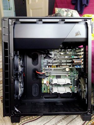

Reply 75 of 269, by voodoo5_6k
Corsair Carbide Quiet 600Q? Nice! I like it. A worthy home for this great system 😀 Looking forward to the additional pictures! I hope the hardware migration completes without any issues.
END OF LINE.
Reply 76 of 269, by slivercr

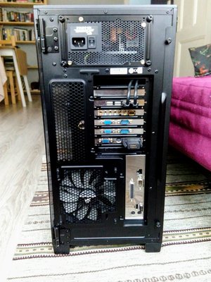

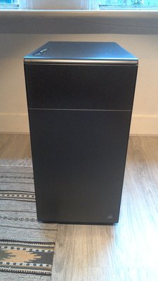

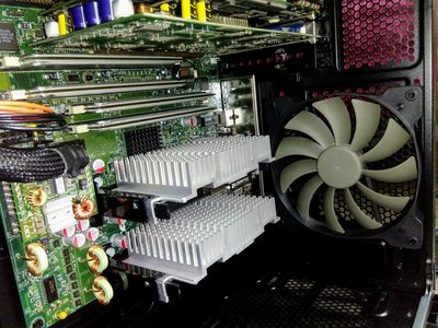

Sorry to keep you—and anyone following this thread—waiting for pics, here are a few quick and not so good ones of the system in the new case. The coppermines are in place while I modify one of the socket 370 heatsinks I use in the slotkets (or find a new one), since I just noticed that after changing the motherboard caps the bottom part of the heatsink sits flush against them, which makes me very uneasy.
Also, you were close but its actually a Carbide 600C, the "Clear" version with the window side panel. I normally steer clear of windows, RGB, etc., but I couldn't resist this one. I dont think I'll go for lights or RGB just yet, but looking inside the case is pretty awesome so far, I like how the dual Slot 1 CPUs look.
1.42 MiB
2576 views
1.86 MiB
2576 views
2.06 MiB
2576 views
1.08 MiB
2576 views
A few things to do still:
  • Make a shorter SLI cable,
  • Get a round floppy cable,
  • Mod a PCI card cover to accommodate the USB cables going out,
  • Plug the CD-In cable, which I just noticed I forgot,
  • Make a new Front Panel Audio cable, so that the front panel connectors are all usable,
  • Find a way to silence the GeForce4,
  • Get some localized airflow on the Voodoos and the RDRAM,
  • Figure out the cooling solution for the CPUs: airduct again, or fans on each CPU for display purposes?
The build is very quiet, even with the case fans set to maximum in the included fan controller. The only audible thing is actually the GeForce's fan, which has a very characteristic high pitch sound to it. Passive cooled as they are the CopperMines max out at 65 ºC or so under load, around 6 or 7 ºC cooler than the recommended max temperature, so they're good. I'll have to see about the Tualatins because past experience tells me they won't allow passive cooling.
Overall I am very happy about this case choice, its cool and quiet. Besides taking care of the things mentioned before—and maybe getting a black floppy drive—the system is mostly in its final configuration.

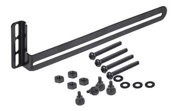

    18.37 KiB
    2530 views
Good catch! I had a similar issues on the CUBX-E (although not related to exchanging caps). There are a few tiny caps very close to the socket and the cooler I intended to use would slightly push on those caps. As I don't want additional heat transfer to the cap or an unknown amount of weight/force on the cap, I searched for a comparable heat sink with smaller base plate (which I luckily did find pretty quickly).
Overall, I like the new home of your system too! However, I can't wait to see the Tualatins back in action to really complete it 😀
END OF LINE.
Reply 78 of 269, by slivercr
voodoo5_6k wrote:
Well, close enough 😉 I too don't like these windowed cases (or window case mods back then), or this modern all-tempered-glass-nonsense. But to each his own... I do however see the point of having the ability to lean back and enjoy the looks of cool hardware installed. Unfortunately, often people then tend to make the case look like the showcase of the lighting department in your building supplies store. I will never get this... Anyhow, I can understand making an exception for this system. Will you place the tower on your desk so you can have a good look?
Hahaha, true about the lights. When I was a teenager I remember the beginning of the "modding craze": people adding side fans, then windows, making fan controllers, etc. I remember back then I really wanted a case with a window, but never had the tools or money to attempt it. I guess I'm fulfilling a teenage dream? I will still not go for lights though 😜 It will not sit directly on the desk, but on top of a mini fridge I have next to the desk: I'll be able to look inside
voodoo5_6k wrote:
If you could eliminate one of the expansion cards (most likely the USB one), you could move the Sound Blaster and the two Voodoo2 cards each one slot down (well, "up" in this case 😉). This way, you have two slots for the GeForce4 and could mount a Zalman VF700-Cu or VF700-AlCu (like I have on my GeForce4 Ti 4600 and FX 5900 Ultra, Retro 3 which is linked in my signature). For the Voodoo2 cards, you could use something like this here to mount one or two smaller fans directly above the cards (can be found on ebay or amazon for OK prices)
The problem is I really need the USB2 card since the motherboard only has a couple of USB1 ports. While I don't need the faster transfer speed, it is nice to have if I need to transfer small files. Also modern game controllers do not play well with USB1, and I need a controller to play the occasional THPS2.
I've thought about a bigger cooler though, in particular I thought about getting an AGP riser card or extension and being able to use the slot on top of (or under, in this case) the AGP card. This would essentially free space for a big cooler, but unfortunately the RDRAM gets in the way.
My plan now is either fitting a small flower cooler I took from a non-working Leadtek geforce fx, but I think it will touch the voodoo's memory chips; or looking for a bigger, passive cooler like what you would see on a geforce 6200, and then set up a bracket like the one you mentioned to blow over both voodoos and the geforce. I'm not sure how well it would work though, and I don't have a thermocouple to test 😢
Yeah, I'm glad I caught it! I ordered a couple of smaller heatsinks which should fit nicely. They are slightly shorter, so I may be able to fit a fan on each without troubles to cool down the Tualatins.
I will update the pictures once the Tualatins are in place!

Reply 79 of 269, by voodoo5_6k
Cool 😀 Maybe you can show the entire setup once everything runs and the system is sitting on its final spot.
I see. But what about using a gameport controller via the additional bracket of the Sound Blaster? This would free up a slot and still let you use a decent controller! I'm using Microsoft SideWinder game pads (gameport version) for games like Need for Speed or sports games. I haven't seen a better controller yet... Let alone more robust. This thing is virtually indestructible and built to last forever.
Sounds good! Those fans don't need to push a lot of air as you have a decent case ventilation thanks to the modern quality case! So they can be relatively slow and quiet although they are small (I'd guess they are 60mm fans or smaller).
