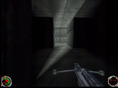

Playing Jedi Knight, ALT+TAB out, run GRAB.EXE exactly as instructed, .tga file is successfully saved, but the the image still suffers from heavy dithering:
208.36 KiB
1625 views
GRAB.EXE
200.05 KiB
1625 views
GRAB.EXE zoomed
The GRAB.EXE shot is identical to a shot taken with Jedi Knight's built-in screenshot tool (F12 and saved in .bmp. by default). There is no need to include the built-in shot, as it looks 100% the same.
If GRAB.EXE grabs an image from the framebuffer, where "colors are stored after dithering into 16 bit to save memory bandwidth and capacity", but before they are upsampled to remove the dithering, then aren't its shots are always going to be flawed? What is the point of GRAB.EXE? Are there games that won't take screenshots at all with Voodoo1 Cards without this utility?
What do you use to take accurate screenshots of Voodoo1 games in Windows 95? Should SUPRGRAB work?

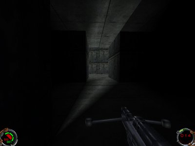

All I know is that SUPRGRAB and Hypersnap DX implement the 4x1 filter (the latter has a nag watermark and isn't actually very precise at filtering)
Reproducing the filter effect was once a passion of mine... especially when V2 and V3+ have their own alternative filters.

derSammler wrote:
You can't take accurate screenshots from a Voodoo card, as the RAMDAC does additional filtering. There's no way to get the final image, unless you feed it into a VGA capture device.
I see no filtering happening *in* the ICS5342 RAMDAC. If there is digital filtering (upsampling) it happens before RAMDAC, if there is analog filtering, it happens after RAMDAC.
And in fact I just looked at some pictures, and the RAMDAC analog output indeed has "pi" type LC filtering.

Here is what Suprgrab gives me with the gamma set to 1.0 (The default value, 1.7, is way too bright in Jedi Knight):
129.58 KiB
1486 views
Suprgrab, default settings except gamma = 1.0
You can save it and zoom in yourselves. It almost looks like they added CRT scanlines. In any case, yeah, I'll be staying away from software solutions to get accurate grabs.

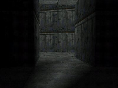

Very cool, thanks. This clearly shows the difference between frame-buffered shot and final image. You were able to force off the dithering filter in environmental variables for your VGA capture; I didn't know you could do such things. If this was to simulate a framebuffer shot, though, why not just use a framebuffer shot? And Voodoos can force a 24bpp mode? Woah. How does this affect framerate?
leileilol wrote:
but the voodoo1 does add purple lines to the screen which gets even more pronounced with higher gamma settings. It's not just those lines either.
Now that you mention it, I can see this effect in elianda's shots. I'm learning a lot from this thread, thanks. *Inserts pensive pipe smoker image*

Here is a raw, uncompressed capture from a DVI2PCIe Duo. The image needs to be shifted down and to the left; I'm still playing with the settings. If this is accurate, it appears that the default gamma of Suprgrab is more accurate than I gave it credit for.
