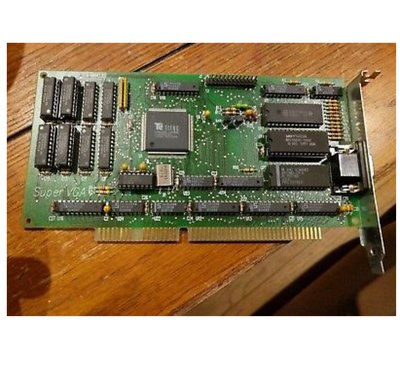

Just curious what the issue may be? Have an older Tseng 4000AX card that works fine other than it has some subtle waves that constantly show up on the screen. Its mostly visible when in DOS and the white text shows these waves real well. When inside of a game or a graphical program it isn't as noticeable. It does not do this with another video card with the exact same system/monitor setup so I am almost sure it is the card but just not sure what? Just seeing if anyone had any pointers of what I may look into to fix this?

Some cards have this issue.
What I think happens is that some ripple on power supply lines gets coupled to sensitive video circuits, such as DAC voltage reference.
The ripple might come from outside the video card (like power supply, another card nearby it, or hard drive etc) or from the card itself (DRAM chips consume current in large peaks).
Try moving the cards around in the motherboard slots or change power supply.
If the DRAM chips are socketed, try swapping another set of chips.
Otherwise, the only solution is to reverse engineer the card circuitry and put extra filtering near sensitive parts.

Tiido wrote:
Putting a 100µF+ capacitor on the power pins closest to RGB out on the RAMDAC chip usually fixes such problems.
Here is my card. Where would I be looking to try this fix?

Reply 11 of 12, by Tiido
*snip*
One of the 3 larger chips next to the VGA port is RAMDAC, the photo is too blurry to make out any details on the markings. You'll want to identify the RAMDAC, then look up its datasheet and then you can see the pinout and identify the critical pins that supply power to the RGB DACs. Sticking a large capacitor across them usually fixes any problems in the output.

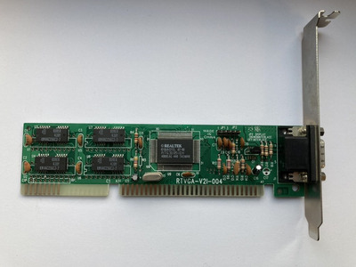

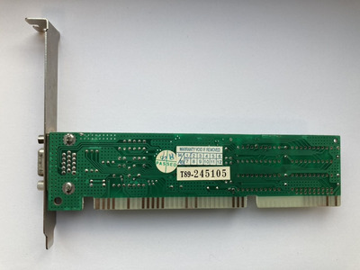

Reply 12 of 12, by holoprox
I have the same problem here, obtained the smallest VGA card ever seen [158/40 mm board]
They never soldered C17, C18,RP1, R5.
Seams R5 and C17 are used when using the other type of ram?
C16 is only 10 mF @25V...
NO ferrites in sight?
