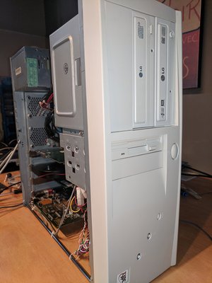

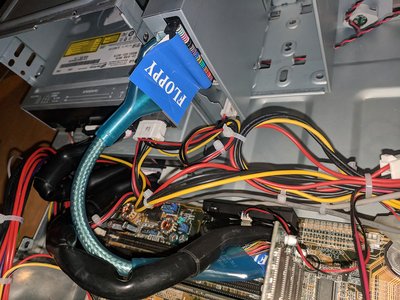

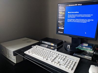

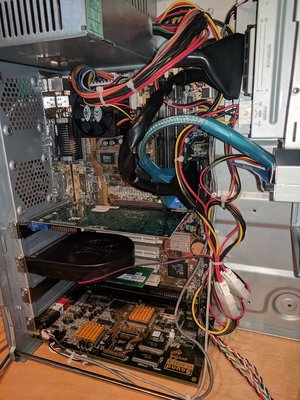

ok. after talking in some threads about my dos hardware here now the introducing of the desktop one in the current config:
• CPU : Intel Pentium1 MMX @ 1 x 200 MHZ
• Memory : 1x64MB SD-Ram
• Video Card : 3dfx Voodoo3 2000 PCI 16MB
• Hard Drive : 1x 80GB IDE (Maxtor)
• Optical : CD-Rom Drive
• Floppy disk : 1x 3½-inch (1,4MB), 1x 5,25-inch (1,2MB)
• Motherboard : Gigabyte Technology GA-5SMM mATX SUPER SOCKET 7, 2x ISA, 3x PCI
• Sound : SoundBlaster Awe64 Gold CT4390 PnP 4MB (ISA) (SoundBlaster 16 CT1770 DSP4.05 SCSI 16-Bit ISA Sound Card w/ DSP (ISA) + YAMAHA DB60XG MIDI Wavetable extension*)
• Case : Standard Desktop ATX case (HEC 7106WW Beige)
• Monitor : Lacie electron 19 blue III, 19-inch
• Operating-System : MS-DOS 6.22, Windows98
* not in use ATM
UPDATE Feb 2018
Years have passed and the specs have changed. Here the 99% final.
• CPU : AMD K6-2 @ 500MHZ
• Memory : 1x128 MB SD-Ram PC133
• Video Card : 3dfx Voodoo3 2000 AGP
• Hard Drive : 1x 8GB DOM
• Optical : CDRW-Drive, DVD ROM Drive
• Motherboard : Asus P5A
• Network : Intel PRO1000 GT
• Monitor : Nec MultiSync 1970NC
• Operating-System : Windows98
Looking forward to the new Simmconn AWE64 batch.
All the stuff is now hanging on my OmniView PRO3 (F1DA104Z) KVM switch. I don't want to have x keyboards and mice on the desk. The Switch will serve later on also my new 486 box and my A4000T.

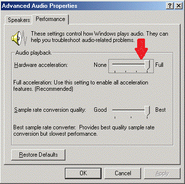

Hmm I tested now a bit around and installed Wing Commander 4 + Win9x patch. The DOS version runs flawless. The Win9x exe makes some trouble. The sound in the video is cracked. So I thought maybe slow CPU issue and I switched to a K6-2 500 and upgraded the memory at the same time to 128MB. Same issue. Any ideas? I will keep the CPU and mem now in that box 😀
I also have cracked sound with the 9x Version of WC4. The same AWE64 Gold, but a Intel Slot 1 System. So maybe it's a problem with the soundcard? I use the latest driver from philsomputerlab.
Or a problem with DirectX Acceleration? DirectX 9.0c is installed. Maybe interesting to test with this setting:

Reply 11 of 13, by Shagittarius
I remember this occurred even at the time for Prophecy. There is either a patch or a fix though, so fear not. Sorry I can't remember the details but I have recently run this game, and also ran it back near the time of release and it always had the video playback skipping issue. But it can be fixed.
Oh, it's just the sound acceleration, or apparently there is a patch, use at your own risk:
https://www.wcnews.com/wcpedia/Video_Skip_Patch
Reply 12 of 13, by NostalgicAslinger
But no patch for the CD Version of WC4 in Windows 9x. Reducing the sound acceleration should solve the problem.
Reply 13 of 13, by maw
Shagittarius wrote:
Works like charm. Totally forgot about. Thanks
It makes it worst here. Videos doesn't skip just the sound is bad like when you play in dosbox and have the wrong settings or not enough cpu power.
