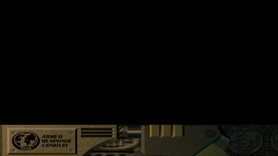

Reply 3487 of 3949, by cesar300
Hello:
I am new to this forum. The app dgvoodoo2 is great or at least with directx games where is working well for me. The problem is in games using glide3x.dll. Tried soldier of fortune 1 and medal of honor allied assault and the problem is strange. My display is 1920x1080 and is set with dgvoodoo2. The game keeps 800x600 to avoid crashes and a big text because at big resolutions is too small. With this setting the game screen "cuts down" misteriously. The 1/3 top of menu is in the bottom and the rest is black screen. This happens with quake 2 and quake 3 engine games (which supports glide, obviously). Any fix for future versions?
And when quitting the game in the main menu, the process doesn't kill leaving an 800x600 grey square in the screen.

cesar300 wrote:
Hello:
The game might uses compressed textures through OpenGL which isn't implemented in dgVoodoo Glide. 🙁 But it's only a tip.

Reply 3497 of 3949, by cesar300
Dege wrote:
Thanks to everybody for the feedback!! […]
cesar300 wrote:
Hello:
BTW, how to run Soldier of Fortune through Glide3? MiniGL was Glide2 IIRC, but I can't remember how to wrap OGL to Glide3. 😦 😦
I downloaded a file named 3dfxvgl.dll from the compatibility list of nglide homepage and in the options menu you can set "3dfx opengl" and I using sofplus. This problem also happens in other games such as medal of honor allied assault using a proper file in nglide compatibility list.
And what about the grey square in the screen after quitting the game from the main menu?
