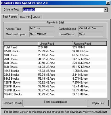

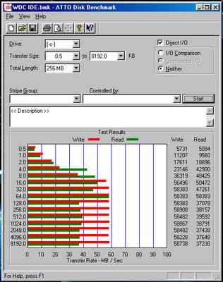

First, the 80gb 7200rpm Western Digital drive that is also in the system:

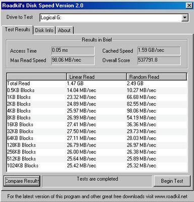

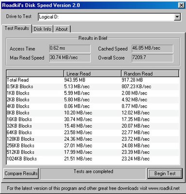

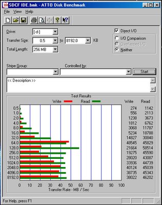

Next, the 8gb SanDisk 60mb/s compact flash card on an IDE adapter:

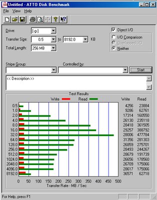

Finally, the new Intel SSD connected to the D815EEA2 motherboard via a SATA to IDE adapter:

I'd say the upgrade was worth it!

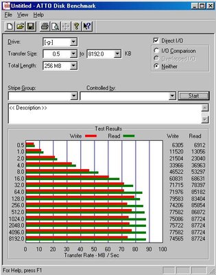

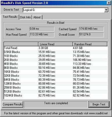

Of course the OCD in me couldn't let this go...
So I present to you benchmarks for the freshly aligned Intel X25E SSD:

It is clear to me something a little screwy was going on during the original round of testing. Despite that, I think it is pretty obvious there was some improvement even with the Fat32 partitioning.
