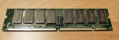

Reply 4 of 20, by arncht
not too easy to find early pc66 sdram. the 32m is suitable to a 1997 mainstream computer.

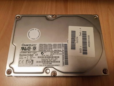

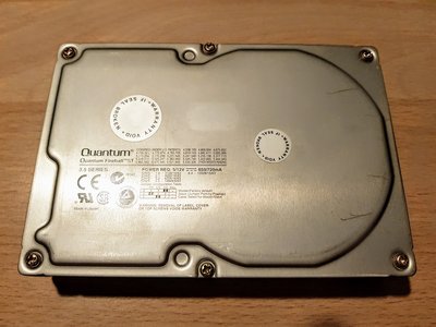

Reply 5 of 20, by arncht
the one of the fastest hdd from 1997, the fireball st. it is 3.2g, i could not find a 6.4g in a good condition.
    1.35 MiB
    4365 views

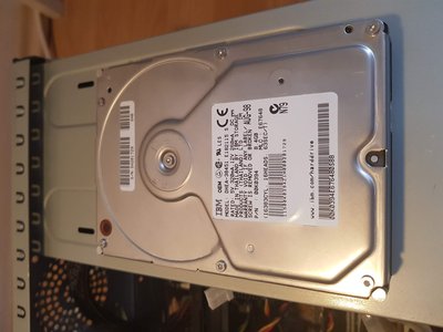

Reply 9 of 20, by arncht
fireball st replaced with IBM Deskstar 8 DHEA-38451 8.4G IDE (available from 1997.09)
and i put back the 64m sd... it was terribly slow with the 97 games, the hdd seeks continuously.
yeah... with this ram and hdd far from the mainstream 😀 if i would use a p2 300, it would be a highend machine.
Intel Pentium MMX 233
Pentalpha Socket 7
Asus TX97-X rev 3.00
Mosel Vitelic PC133 SDRAM 7ns 64M
Asus 3DP-V3000 4M PCI
Diamond Monster 3D 4M PCI
Creative Sound Blaster AWE64 Gold PnP CT4390 rev 01 ISA
Gravis Ultrasound Plug & Play 1.0 8M ISA
IBM Deskstar 5 DHEA-38451 8.4G IDE
LG GCR-8523B 52x CD-ROM IDE
Mitsumi FDD
ECE1135
Enermax EG365P-VE
    413.29 KiB
    4153 views
Overdoze of the demoscene

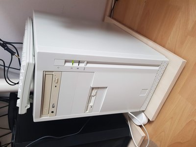

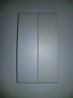

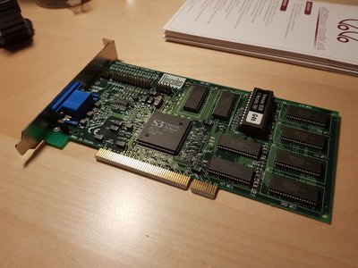

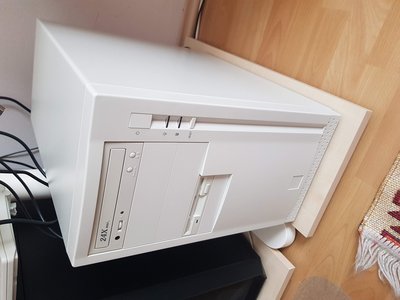

Reply 12 of 20, by arncht
the ibm hdd was so annoying, i turned back to the "mainstream" line. i also did some research about these months to get the more "typical" configuration:
LG PC66 SDRAM 15ns 32M
Hercules Terminator 3D/DX 4M PCI S3 ViRGE/DX
Quantum Fireball ST 3.2G IDE
1.61 MiB
3634 views

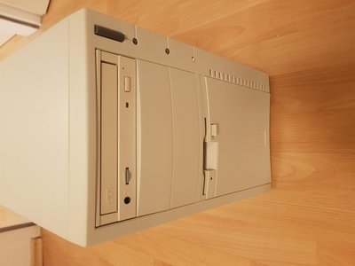

i also found a NOS case. the styling is very typical "97". unfortunately the front of the case is slightly yellowish, i got an another panel with it. it is possible, i will move back.
1.25 MiB
3634 views
305.94 KiB
3634 views
that was the "original" case:
1.76 MiB
3633 views
Reply 13 of 20, by bytestorm
Sweet case! Man I hope I find a short one like that.. but retro cases are getting hard to source now days.. not even the second hand shops around here takes em old pcs anymore 🙁
Reply 14 of 20, by arncht
i did not like this case, i put back this rig to the slim 😀 it looks good, but it is yellowish, and rubbish quality compared to the old one. maybe after some retrobrighting, i try again.

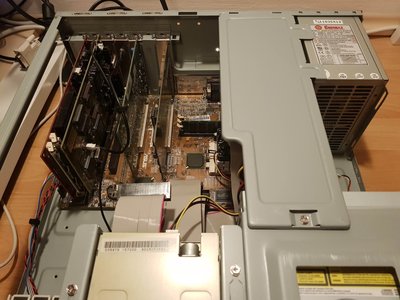

Reply 15 of 20, by arncht
replaced the noisy (new) fan to another one 😀 the new build is sooo clean.

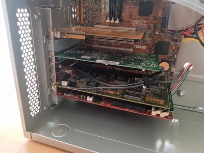

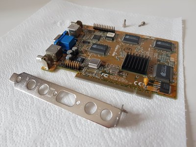

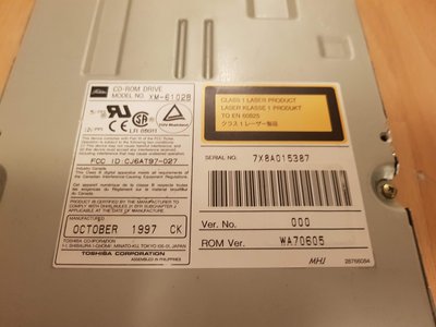

Reply 17 of 20, by arncht
target date changed: 1997.09
updates:
Asus 3DP-V3000 4M PCI NVIDIA Riva128 - better dos/vesa compatibility than the s3 virge/dx (i watched 50+ dos demos from 95-98)
Toshiba XM-6102B 24x CD-ROM IDE - from july of 1997, matched style, model, but the color must be fixed
TK2002 - it is better with this cdrom
    667.17 KiB
    2857 views
    254.97 KiB
    2857 views

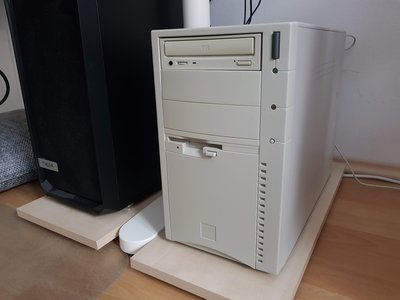

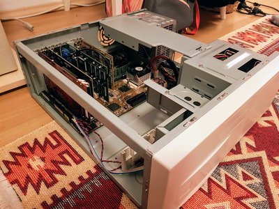

Reply 18 of 20, by arncht
updates:
HDD Quantum Fireball ST 4.3G IDE - same, just bigger
Case In Win IW-A500 - it got my p3 case, it fits better to 1997, the odd needs some retrobright 😀
    1.41 MiB
    2624 views
    1.18 MiB
    2624 views
    321.79 KiB
    2624 views
