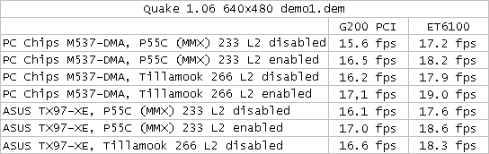

feipoa wrote:
Probably DOS Quake. Just wondering if the accelerated graphics cards are making the L2 cache less important.
You were true, the accelerated graphics is diminish the advantage that can give the L2 cache. Here they are DOS Quake 1.06 640x480 results:
The attachment benchmarks.PNG is no longer available
Video card compatibility matrix for DOS games | ATI3DCIF compatibility matrix | CGL API compatibility matrix
Reply 124 of 562, by feipoa
Looks like with accelerated graphics, the use of L2 cache provides around 1.5% performance increase, while without accelerated graphics (software mode) the use of L2 cache provides about a 5.8% performance increase. Makes me wonder if L2 cache provided a better enhancement on older boards, e.g. 386, 486, and socket 5. 5.8% seems like such a small increase for the cost of cache back then.
Reply 125 of 562, by Gona
Yes, these results show that without accelerated graphics the use of L2 cache provides 5.6 - 6.1% performance increase. Likely on slower CPU based systems the motherboard cache gives better performance increase as on faster systems the motherboard cache gives smaller accereration. Might this was the main reason that CPU manufacturers has moved the L2 cache from motherboards to the CPU package/PCB (off-die) and later inside to the CPU core (on-die).
With same CPU and cache parameters 430TX (TX97-XE) is faster than VIA VPX (M537-DMA33), but with Tillamook, TX97-XE cannot work with L2 (disables it) and PC Chips M537-DMA33 with working L2 cache is faster than ASUS TX97-XE (if the graphics is not accelerated).

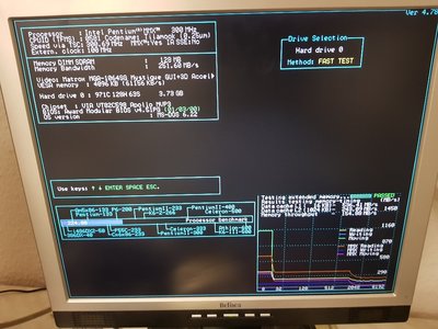

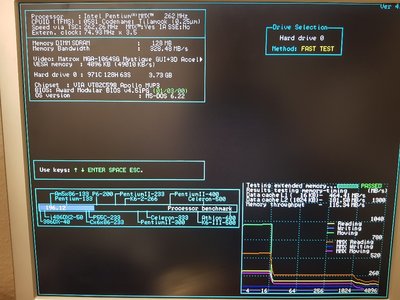

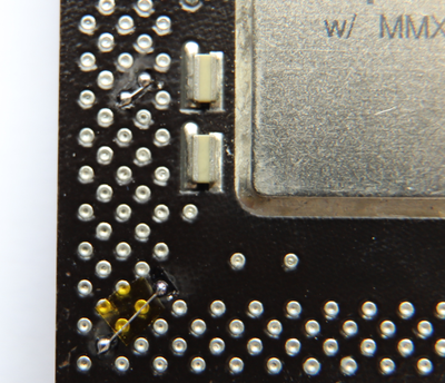

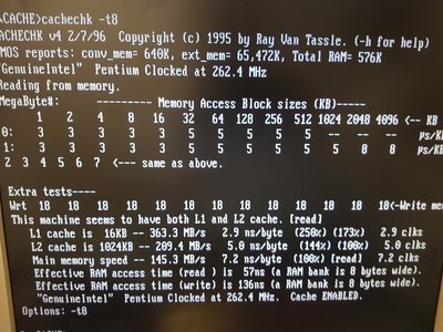

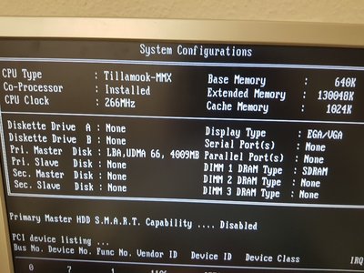

Got my DFI P5BV3+ working with this CPU!
Simply added bridges between ADS#/ADSC# and BRDY#/BRDYC#
Cache is on, CPU is working fine at 300MHz, see below for results.
266MHz (75x3.5):
The attachment 20180813_231734_resized.jpg is no longer available
The attachment 20180813_231845_resized.jpg is no longer available
The attachment 20180813_232023_resized.jpg is no longer available
300MHz (100x3):
The attachment 20180813_232408_resized.jpg is no longer available
The attachment 20180813_232456_resized.jpg is no longer available

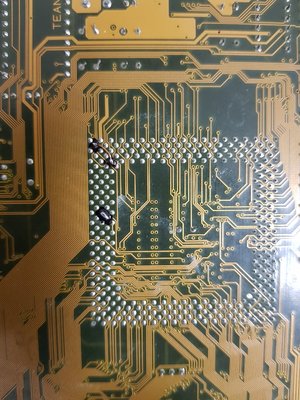

Reply 129 of 562, by LeFlash
Wires:
The attachment 20180813_232510_resized.jpg is no longer available

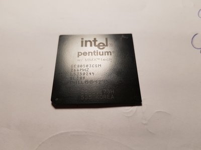

Bonus footage:

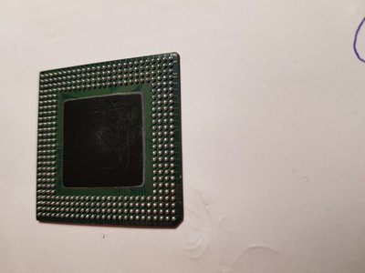

Picture of a Tillamook in BGA-case, which i reballed, just in case:
The attachment 20180813_221119_resized.jpg is no longer available
The attachment 20180813_221110_resized.jpg is no longer available

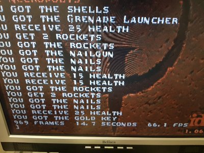

Reply 130 of 562, by LeFlash
System seems also stable at 350MHz, getting 70fps in Quake timedemo. 😉
One could also mod the CPU and not the board, because the MMX has trough-hole pins. That's the next thing i'll do to keep my MoBo stock and test the CPU in other boards.
Reply 131 of 562, by meljor
Wow! Very nice work! Did it boot beTiffani Amber Thiessenfore Tiffani Amber Thiessenthe mod (without cache working) or did it not post at all before the mod?
And could you make clear which pins to connect on the UPPER side of the cpu? As i can not see too clearly which pins you connected.
THANX! I want to try it also, beeing able to use a super socket 7 board with this cpu would be awesome.
Reply 132 of 562, by LeFlash
It booted before, but only when i disabled the cache completely. Otherwhise, it got stuck after OPROM-scan.
Just look at the picture of the solder joints. Bottom/left is the key side of the cpu.
You just need to rotate the cpu in your head. But i'll do some pictures after i modded the cpu itself!

Reply 137 of 562, by LeFlash

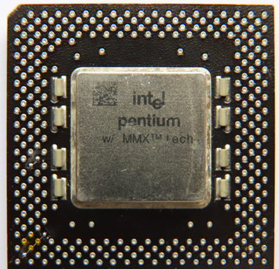

In theory - yes.
The Tillamook PGA are alle the same, at least the datasheet says that.
BTW: I moved the mod from the MoBo to the CPU itself. Works! Unmodded CPU does not boot, modded one does - last test successful!
The attachment IMG_0993.png is no longer available
The attachment IMG_0992.png is no longer available
