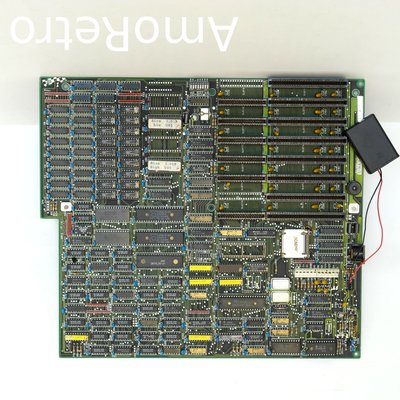

so I've got a beautiful, old 286 up and running again (I love tinkering with old computers) and because I was veeery young when I got my first 286, I can't really remember much about memory management.
What I have found out/done so far:
- The motherboard has 1 MB onboard
- BUT it allows me (via jumper config) to either use 640k conventional memory and "ignore" the remaining 384k OR use 512k conventional memory + 512k of UMA (upper memory).
- I have bought, assembled and installed one of these 2MB EMS cards: https://texelec.com/product/lo-tech-ems-2-mb-pcb/
- If I configure the motherboard to 512k/512k, the biiig downside is, that I'll never get more than 500-something conventional memory free, regardless of how well I optimize driver loading
- If I configure it to 640k/0k, I don't have UMA, don't have himem.sys loaded, don't have UMB and so on.
- EMS memory (link above) is installed and LTEMM driver is up and running, 2MB EMS detected and ready

btw. himem.sys says "no available extended memory was found" when using the 640k/0k config.

Reply 1 of 13, by gdjacobs
What chipset are you using? Is it listed in the links below?
http://ibm-pc.org/drivers/unsorted/memory-1/memory-1.htm
http://ibm-pc.org/drivers/memory/memory.htm
Reply 2 of 13, by stamasd
Don't be surprised that himem.sys complains it can't find extended memory, because you don't have extended memory. XMS is memory available to the CPU directly (thus not the 2MB of EMS you added because that's not directly accessible) situated above 1MB. You don't have any of that.

Reply 6 of 13, by nemail
Hi
thanks for your answers and sorry for the delay!

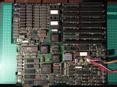

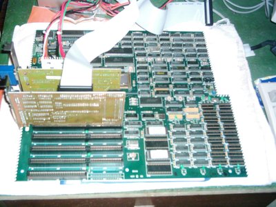

gdjacobs wrote:
I have this board, any idea please which chips are the chipset? Should be high-res enough to read all the names on the ICs
1.76 MiB
1689 views
I was afraid that this was the case.

My Schneider Tower AT, for example, has the same 512/512 and 640/384 options.
My board is configured via Jumpers and BIOS. Jumper and BIOS settings have to match, otherwise it complains "memory error" during boot.
Jumper options are: 256KB, 512KB, 640KB, 768KB and 1MB.
BIOS options are: Memory below 1 Meg and Memory above 1 Meg.
Regardless of what I do, if I want to have 640KB below 1 Meg, there won't be any memory available above 1 Meg.
So I can do like 512K/512K or 640K/0K. The board is fully populated so it has 1MB installed physically.

Reply 7 of 13, by root42
I have a VERY similar board, only with additional FDC on board. I think indeed the best way here is to set it to 1 MiB below, and if you really NEED more memory to use an EMS card. Very few software needs XMS, and running Windows on this machine in standard mode wouldn't be much fun. This is also why I have another Suntac based board with 2MiB (max 4MiB) of RAM. This runs Windows 3.1 really fine.
Your board and mine are really ancient, and I would suggest just to use it as a fine and nice DOS game machine from the 80s. Because it is probably from way before 1990... It is also not using any highly integrated chipset such as Suntac, Neat or the like. It is all discrete components, as you can tell from the insanely high component count...
The attachment 286_10_512.jpg is no longer available

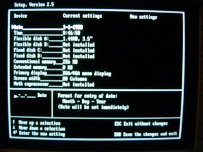

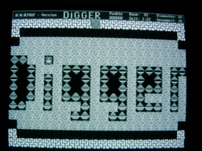

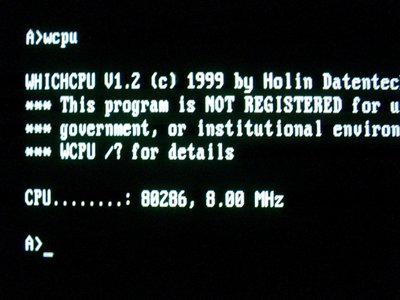

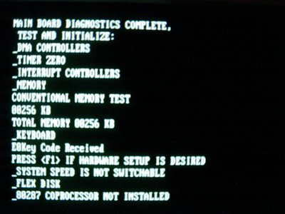

Now that's funny! I had a similar looking 286 mainboard once! 😁
It had 256KiB of RAM and ran PC-DOS 3.3!
Heck, even Digger was playable @8 MHz! 😁

Reply 12 of 13, by root42
After double checking I must say that mine seems more modern with a CHIPS chipset:
1.03 MiB
1662 views
But it also has this weird 512/512 split of the memory.

Reply 13 of 13, by Jo22
Thanks for the picture! Looks neat! 😉
It's a bit ironic, though, that we (including me) consider the OP's board as an oddball.
In reality, this board behaves "sane" or logical.
It uses a linear or contingous memory layout as some computer person of another platform would expect:
The board interprets "no memory remapping" the correct way -> the whole 1024KiB are in order. No gaps.
This is in contrast to most x86 folks who consider "no memory remapping" as 640KiB+384KiB of nothing+384KiB of extended memory
and "with memory remapping" as 640KiB+384KiB of upper memory (which is the normal way of describing it on x86 or PC/AT).
