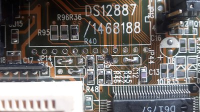

So I have/had a Biostar MB-8433UUD-A V3 with the soldered on rtc. I attempted to remove it and install a dip socket but the chip didn't come off clean and damaged tracks, I still installed the socket hoping for a miracle but now it doesn't post it all 🙁 not even lights on keyboard when booting 🙁 I was hoping the worst case scenario would be stuck with empty battery as was before but it's much worse.
The new rtc did get warm/hot when trying to boot with no post, not sure if this is good at all, also got no post with rtc removed.
Here is a picture it looks to me that definitely that track right under the writing r40 has been ripped off, probably more damage too, not sure if its any multilayer tracks inside which got damaged too. I might take off the dip socket and try bridge that track but don't know if it's worth the effort.
Anyway I know everything I ready said not to force it desolder and pump out from the back but yeah only a few joints got sucked out successfuly others didn't want to budge and I got too excited and forced things, big lesson here.
Not sure If I am asking or simply posting my experience but any feedback welcome
Whats my chances of revival 5, 10%?
Sorry for phone pic
Reply 1 of 29, by mcobit
If you are unsure, please give that board to someone who knows what he is doing. It might be revivable.
First test for continuety and shorts. Figure out which traces really are broken.
Then bridge them with some single strands of multicore wire.
If a pad doesn't get sucked out on first try, try again.
I have a similar board I repaird successfully after the previous owner dremelt into the board while trying to modify his rtc.

Reply 2 of 29, by feipoa
I would bridge the broken traces. sounds like you will need to remove the socket, assuming you soldered one on. How else would you be testing this board otherwise? I may have a photo of this region without the socket, but I am on holiday now and am not at my computer to check. I cannot imagine a broken trace causing the RTC to heat up, that is, unless it is installed backwards.

Reply 8 of 29, by feipoa
I didn't realise you ruined so many traces. I have several of these boards which I had to desolder the RTC. I do not own an automatic iron+pump and did it the old fashion way, that is, with a blue hand pump and a soldering iron. It can be quite tricky because the solder doesn't flow so easily, especially on the GND and VCC pins. You must be very very careful and need to use two different tip sizes, one small and one tiny. The tiny one is needed to jam into the via to get the under solder, but I had to crank my iron up to 850 F and do several rounds, just one one pin. At 850, you also cannot leave the iron in there long at all. This particular job, though I've done it on about 5 motherboards, was one of the more painful desolder jobs due to the state of the existing solder. You best look for version 3.1 of this board as they all should have socketed RTCs.
I also believe this board needs an RTC, irregardless of the battery state, for it to boot. You might want to find some solid core, 30 AWG wire for this repair job. It will look a lot neater.

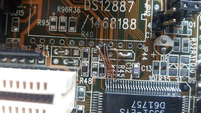

very exciting news!
Today I decided to return to this project.
1. I ripped all the jump cables off the back, used very fine sandpaper where the suspected scratch on the traces was, after having a good look in the sun with magnifying glasses I decided they may not be cut through as suggested previously.
2. removed the dip switch, resoldered the jump cables on the front of the board under the dip switch for the original traces I broke.
3. really took my time to make sure the dip switch pins are making good contact with enough solder.
4. Noticed the umc chip near the rtc had a trace that was lifted from the motherboard but still connected so added some solder to make it stronger
5. connected the board with a pc card and nothing in the middle pc slot.
6. final attempt on the furthest pci slot from the rtc and success!

Reply 14 of 29, by treeman
I tried everything and the cache would became too hot to touch by the time the system booted and detected no cache.
Luckily it was the cache chips not something shorter somewhere, installing new cache + tag got this board up and running + bios settings that stick now with rtc successfully installed through a dip socket. Now time to pack it up nicely and put away for the next crazy adventure

here is my finished switch and the 3 cables that brought it back to life.
I have installed the rtc after taking the picture and fixed the 4th pin on the dip from the left don't worry.
touched the isa slot a few times with side of solder iron so has some battle scars.
dip slot is not melted but the marks on middle barriers are from long nose pliers from installation and removal done quiet a few times.
happy end, thanx every1

Reply 19 of 29, by Pabloz
that is an incredible and usefull great copper wire
where do you guys take that wire from? i have Kynar 30 awg which is used for modchips but i think the wire is very thick
that copper wire looks way thin and more usefull for motherboard repairs.
where do you guys find that wire?
