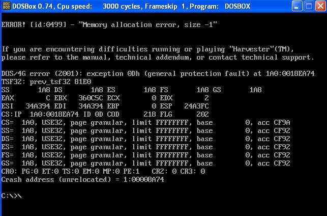

heres my problem. ive gotten harvester to run just peachy with dosbox. however, it crashes at very specific times. lets say i walk into a room and talk to someone...so far so good. then if they turn hostile and attack me, the game crashes with the error "ERROR! [id:0499] - "Memory allocation error, size -1"". if i walk into a room and someone or something is already hostile toward me, i have no troubles. ive managed to get very near the end of the game by avoiding this bug...but i cant ignore it any longer if i want to finish it.
sometimes when it crashes like this it also gives me the address of the error, with all that extra tech info that i cant read. but when it happens, it also mentions something about a "missing segment". not sure if this matters. any help is appreciated.

Have you tried allocating less memory? Negative values often mean that you are making more RAM available than the game can count, so it's wrapping around to something weird and causing an error.

Some other things to try:
use the full or dynamic core (dosbox.conf),
use xms=false, ems=false with very high (64)
and very low (2?) values
try the debugger enabled version, maybe there's
some usefull info around the crash in the logs
Does the same thing happen if you just start the game and
play for a while (that is no saving etc.)? Also try to have
loadfix loaded when testing this last thing.

well i found out the problem...it was a botched installation. my installshield has been flaky, and i recently fixed it (it was an odd problem). now that ive reinstalled the game again, i get no more crashes! now i can KILL WHOEVER I WANT!! YAY! ahem...anyway, thanks for the help all the same everybody. i had fun learning about dosbox.

Yeah, this isn't *fixed* in the slightest, not here. I have done all of this stuff all day, including installing from dosbox, & not using the install outside of the dos installer. I'm having the exact same issues & even used all the things from the other threads were also tried that many others never seemed to fix are having the exact same issue with no results. Gawd, I wish there was more information on this.
Please if anyone has any info out there, share it, every place I use to go for info on this game are long gone this seems to be all that's left... 🙁
My dosbox runs everything fine until I make a violent move on anyone or they change from a neutral to violent state against me & (like they react to my violence or change into violence during conversation), the moment they do, it gives that image, & no way to play this game. 😠

Yeah, ANYONE who has this problem the issue is not the installer itself, it's the code made with the installer, it's not the copy, it's where you install the game. The problem arises if you install it ANYWHERE BUT c:\ DO NOT INSTALL in the SUGGESTED c:\HARVEST with the installer. I just wasn't made clear enough by the vague discussion that THAT is what the problem really is, sheesh. 😳 😁
