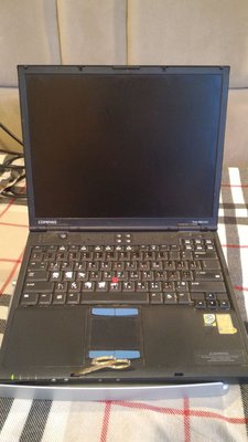

I have an old laptop, a HP Compaq evo n610c running Windows XP, which I keep permanently on the kitchen table, and I use it as an ebook/comic/magazine reader. But now it's developed some sort of problem with the screen. When I turn the laptop on, it displays the Compaq logo and "Press F10 to change settings" (which is what it should display), but then the screen goes black, and doesn't display anything else ever, until I turn off the laptop, then turn it on, in which case it shows the logo screen, and then immediately after that the screen goes black and stays back, you don't even see the BIOS settings if you press F10 to enter them.
The laptop seemed to run otherwise, just with no display, so I've plugged it into an external monitor, and using the monitor, the laptop works fine (minus the laptop's own monitor, which stays black). When I boot the laptop with the external monitor plugged in, the external monitor shows the Compaq logo (which now doesn't appear on the laptop's monitor, which instead stays black from boot up) then the usual PC stuff as it boots up, Windows loads, and everything works fine. So the laptop is perfectly usable with the external monitor, but when I remove the external monitor of course, the laptop is unusable as the laptop's own monitor will display nothing except the Compaq logo screen when first booted up.
And when I try to get the laptop to use both the laptop monitor and the external monitor together, via the display settings menu in Windows, the laptop seems to think it is doing so, but the laptop's monitor stays black.
To my thinking, it can't be a driver problem, because it happens before any software is loaded (immediately after boot up, you see the Compaq logo then nothing else, not even if you press F10 to access the BIOS), it seems unlikely to be a screen problem because the screen does work properly for a couple of seconds for the Compaq logo (though maybe the screen is knackered, and can't display anything higher res than that now, or something similar), and I don't think it's the laptop somehow thinking it should immediately disregard the laptop screen and use an external screen as there's no setting in the BIOS for it, and the only way to toggle between them is by pressing FN + F4, which is a Windows program function, and should only affect Windows sessions, surely? I've googled, but as far as I can tell there's no setting that makes the laptop, immediately on booting, divert the screen display to an external monitor even if there isn't an external monitor present.
It's not a problem of course, I can still use the monitor when killing time, I'm more curious about the cause of the problem than anything else.
I should say, the laptop is permanently offline, and I've not put any programs or ebooks or anything on the laptop for ages, so I don't think it's malware-related (and I don't see how it could be anyway, since even the BIOS won't show up on the laptop's monitor, but only on an external monitor), the laptop has not been dropped (or even moved) at all, and only I use it. I've tried pressing FN + F4 at all stages of everything, but the laptop screen doesn't come on, and if I press FN + F4 when the external monitor is plugged in and displaying the Windows desktop, then the image on the external monitor flickers very briefly (as though a screen-wide area an inch or so high, flickers on the external monitor, the laptop's monitor doesn't change or show anything at all), but then there's no further change, the external monitor shows the desktop as normal, but the laptop's monitor remains back as it does all the time.
I've tried booting from a CD, and it's the same situation. The laptop shows only the Compaq logo, then stays black, even though the laptop boots the CD. If I plug the external monitor into the laptop, then the external monitor shows the CD booting and running fine. Whatever I try, the laptop itself seems fine, aside from the laptop's monitor.
The only other symptom I can find is that shutting or opening the lid no longer seems to 'register' with the laptop; the laptop has always been set to hibernate when the lid is closed (to save the PDF reader and/or ebook readers' in their current state to save me having to remember what was open and where), and come back to life when the lid is opened, and so far that's always worked. But now it doesn't, and when I go to the Power Options, and tell the laptop to hibernate when the kid is closed, it doesn't. If I tell the laptop to Stand By when the lid is shut, it doesn't do that either. The laptop doesn't seem to register when I open or close the lid anymore, which to me would suggest a hardware problem, which of course would go a long way to explaining why the screen always stays black, but if so then why does the screen always show the Compaq logo screen (except, of course, when the external monitor is plugged in).

My first guess would be that there is something wrong with the inverter supplying power to the LCD; although normally I would expect that, if it's broken, you will have no backlight, ever, I don't think it's unheard of that a dying inverter would be able to power the backlight briefly for a few seconds, before going out.
However, as you mentioned that you also have a problem with the lid close switch, I suspect that that is actually the culprit: it must be permanently stuck on "lid closed". Even if the system is configured to "do nothing" upon lid close (not standby, nor hibernate), it still turns the display off. It is also conceivable that the logic to do so does not kick in until the laptop has been on for a couple of seconds, which is why you would still see the logo.
The switch on these laptops is mechanical, so first check if it might be physically broken or something is jammed in there, which prevents proper operation; if mechanically it responds fine, but still does not trigger any action (and the display is always off), then it would be time to check the circuitry (not that I would know how to go about it).

Reply 9 of 11, by dr_st
I think it may actually be inside the base where the latches go when the lid is closed. Can't be 100% sure now, and it's unlikely I'll see my N610c in the next 3 weeks. 🙁

Reply 11 of 11, by dr_st
So, it took me longer than I thought, but I got around to testing the N610c and I think I can confirm my initial assumption.
Your problem almost certainly has to do with the lid close sensor. The sensor is located, as I remembered, at the front of the base, where the left latch goes as you close the lid. On the attached picture you can see that the screen is off due to the small scissors I jammed in there.
Furthermore, when I turn the laptop on, while the scissors press down on the sensor, I get the exact same behavior you described: Compaq logo visible at POST, then screen turns off whether you enter the BIOS or continue the boot process.
So I would check if perhaps something is stuck there - try to push down that hole with something thin (emulating the latch action) - there should be a thin piece of plastic moving up and down as you do. If it's stuck in the 'down' position, it will behave as if the lid is closed.
Now, if mechanically there is no problem, but the sensor itself is defective / shorted, this may be harder to fix.
