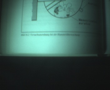

Among my favorite books is PC-Bastelbuch (PC thinker book, #3-89090-331-2) by Kai Hamann, which focuses on game and Centronics port.
    22.11 KiB
    1645 views
    The book.
    14.48 KiB
    1645 views
    A pedometer/odometer for a hamster wheel. :)
