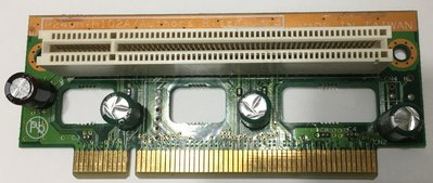

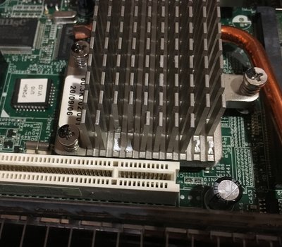

Bringing this thread back from the dead.
I have figured out what the problem is with the AW744-L2 card and the HP T5720 thin client.
It is PCI bus noise.
Fully populating the capacitor places on the PCI riser card completely fixes the issue. I am guessing this will also fix issues with "compatibility" with other cards as well. It should also significantly clear up the audio output if you are using a different sound card.
For the smd ones, I just grabbed some that were the correct physical size off of a dead video card. I tinned the pads with my iron and then used a hot air solder gun to melt the solder and each cap just dropped into the proper place though I did hold them from blowing away by using a pick on one side to keep them from moving from the air current from the hot air gun. Temp was at 350F.. just depends on what temp your solder melts at.
For the through the hole electrolytic capacitors, I used these (Left to right when looking at the Riser)
TC4 (12v line) - 16v 220uf - this one was a bugger to do since there was crappy solder in the holes from the factory. Had to set my soldering iron to 425F for this one.
TC2, TC1, TC3 - 6.3v 1000uf - these were super easy but I did have to carefully scrape the solder pads to expose the copper as it seemed like there was some sort of coating on them. Soldering iron temp was set at 375F for these.
I also had to remove 4 of the fins from the chipset/GPU heatsink for the caps to clear. After looking at it, it looks like that is not necessary if you mount TC4 and TC2 on the back of the riser.
