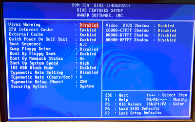

Then perhaps it's the BIOS settings. Something either in the IRQ assignment department or the PnP OS (Y/N) option.
Reply 17 of 27, by nemail

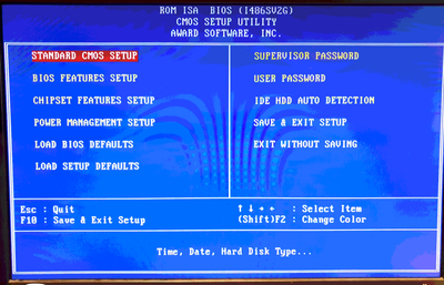

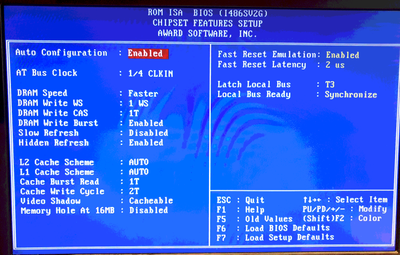

Here's all I got in the BIOS:
213.26 KiB
2052 views
262.96 KiB
2052 views
242.93 KiB
2052 views
