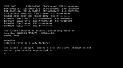

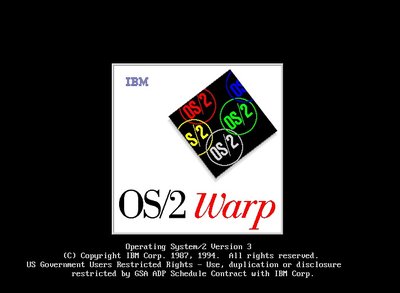

Just gave OS/2 a try again. It immediately crashes trying to load CR2 with a value. Then I found out that it was checking bit 31 and 0 for invalid values for CR0, while actually loading the a non-CR0 control register:S
Immediately fixed that. Now it at least continues on to the initial screen of the setup, prompting for a disk change.
It doesn't seem to continue on. The OS/2 warp 4 boot screen is displayed, but the Floppy Disk Controller motor keeps running, so it's probably hanging somehow?
60.96 KiB
2149 views
OS/2 warp disk 1 loading
Edit: Just tried OS/2 warp 4 on UniPCemu's 80486 emulation. This results in the following faults and screen(I do see it throwing a whole range of Page Faults?) :
80.57 KiB
2147 views
OS/2 warp 4 setup crashing?

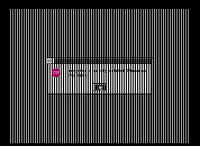

Reply 55 of 91, by superfury
Just tried doing a clean install of Windows NT(with hard disk formatting completely(which according to the hard drive emulation isn't anything other than just reading the entire hard drive(not writing anything during that point in the setup))). It still crashes out in the same way(with the very same error message as before)?
The graphical mode also seems to have it's entire background (everything but the mouse) only rendered half or partly for every character? This happens even on the VGA emulation?
The only things that don't have that issue is the mouse, the STOP logo and the close button itself? All other components seem to have that issue?
Anyone knows something about this issue?
