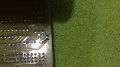

I have a 486 rig that I'm working on for some time. I had this odd problem: Turbo LED is very very dim. I changed the leds, etc, but nothing worked. Then just by chance, I see this:
157.04 KiB
871 views
A resistor soldered underside the board on to the LED pins. (sorry about the bad photo)
Why on earth it was needed? May I remove it?

One of the previous owners must have wanted a dimmer LED 😀
yes you can snip or solder off that, as mobos have already a proper LED series resistor if the connector post is labeled as LED post.

I'm skeptical. You need a complete circuit, which usually looks something like +5V -> Resistor -> LED -> Gnd. (Or the resistor could be on the Gnd side of the LED -- doesn't matter which.)
If that was an after-market bodge, then you might have +5V -> Resistor -> LED -> Resistor -> Gnd, in which case it would be safe to remove that extra resistor. Except... what got removed to redirect either the high or low side of the LED through a resistor? Someone would have had to sever the Gnd or +5V connection and put that resistor in between, so just snipping the resistor is likely to leave you with an open circuit.
If you bridge those pins without a resistor then fine .... unless they removed the factory resistor and put a higher-value one in its place. If THAT'S the case, you need to remove that one and put a lower value in. Otherwise there's no current limit to the LED and it'll burn itself out (or damage whatever is controlling it.)

If the resistor is soldered across the connector so it is in parallel with the LED. removing it wont break the circuit but shorting it out would draw a significant amount of current through the built in resistor. A lower value would actually make the LED dimmer because the current will have an even easier path to flow around the LED.

Oh ... yeah, I didn't even think about someone adding a resistor in parallel to the LED. That's a good point. That would explain a lot, and would make it really easy to remove and return the circuit to stock.

I removed the resistor and LED is working as it should be now.
This board came from a very old industrial testing device, used to measure forces on springs. Since I'm the only expert in pre W95 stuff, I helped IT, as usual, to make the device working with a newer computer and this baby become obsolete and surpluss. There was nothing extra ordinary connected to the LED header, It was just a run of the mill no-name 486 PC in a beige mini tower, except being EISA and having quality parts like a Tseng Labs VGA card.
While it was working in its original case, turbo led was not connected and turbo button headers was shorted with a jumper. I really have no idea what they were thinking.
