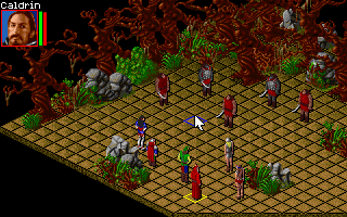

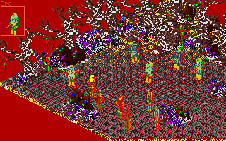

now, about Realms Of Arkania : Star Trail, it seems ther's still the same graphic glitch during combat phase, when magic is used (ex, lightning strike) the screens flashes and shoud return to normal palette...but it didn't do it with dosbox, and we'r locked into a bad color palette for the rest of the fight. It's annoying since we can't really see lots of vital info, we need to use the auto computer fight mode to finish the combat phase.
colors return to normal when the fight is over, so the game is still playable..sort of.
this glitchs exists since a long time in dosbox, hoping that with time dosbox will finally get it ok...so i speak about it here and now, hoping the team will take a look at this problem.

    before spell

    after spell

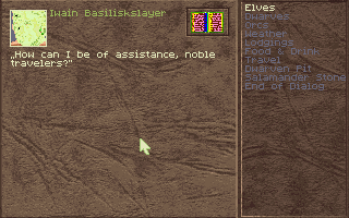

    glitches also appears during dialog

It seems I was wrong in my assumption about it being caused by sound settings (sorry...). So far I was able to reproduce this bug in only one situation (using CD version of the game): when START save game was used during the current game session ...
When I had another (later) save game and started game from it (without using START in that session), it was ok, no graphic bug (even though that save game originated from a game started by START save - but I ended and restarted the game between saving and loading!).
Frankly, it does not make much sense - what is the thing the game does not like about the START save? Does something get corrupted in introduction? Or is the save itself bad? Or does it depend on the time spent in game?
The described pattern was quite reliable...
Sequence with bug:
1. starting the game
2. loading the START save
3. going outside of city into combat (lighting corrupts colors)
Sequence without bug:
3. Saving the game after intro
4. exiting game
5. restarting game
6. loading the save
4. going outside of city into combat (lighting works ok)
Mirek
Reply 10 of 22, by mirekluza
Rank DOSBox Moderator
DOSBox Moderator
What has ems to do with it?
I had it disabled (I did it before for Ultima 7), now I enabled it and in both cases it behaved the same.
I think something gets wrong during intro (when there is that elf ambassador and another guy who both want salamander stone). Saves before that behave as START save (graphic glitch), saves after that are ok. It seems that something gets corrupted there and it makes itself visible later when using magic in the next fight.
It looks like it is really a DOSBOX bug (it was ok when run natively).
Solution seems to be to save after receiving those tasks, exit game, start it again and load the save. I do not know whether this is the only instance of the problem or there are other things like that in the game.

Reply 12 of 22, by billoute
yes it's a very strange bug, and ther's definitely something wrong in the intro (when the ambassadors are speaking) : look carefully at the bitmap around the main picture, at the first display it fades into black when it shouldn't...when screens change it is redrawn properly.
too bad, since the glitches appears right at the start of the game, i'v never tried to play and save further into the game under dosbox. Since i'v still my old 486 i 'v always played this game on.... and i can confirm, starting the game, saving after the intro, quitting dosbox and restarting, loading my save : et voila, no more glitches, all is perfect...
this confirm that's something wrong with this game and dosbox, ocurring during the intro and corrupting some data....restarting the game without quitting dosbox don't help for the glitches, dosbox must be shutdown before going further.
anyway, big thks for your help, i can now play Star Trail under dosbox. Nice enough, the third game in the series (Shadow Over Riva) works perfectly....

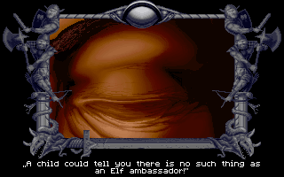

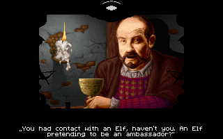

i'v just checked another thing, in fact the game becomes corrupt again later..when you spend your first night at some inn, theres a cutscene similar to those seen at the very start of the game, where you see a thief sneaking into your room etc. just after this cutscene, glitches are back. same causes, same effects. saving, quitting dosbox, reloading..all's fine.
i'v no skill as a developper/debugger but if you want to search for this bug, look at something happening during cutscenes (speech of the two amabassadors, then the thief speech), without any doubt, ther's something fishy here corrupting the memory...
    20.14 KiB
    1717 views
    notice how the bitmap around the main picture is missing (black)
    14.7 KiB
    1717 views
    and the second after, it's back again but after that you know for sure you'll have gfx glitches all the way
