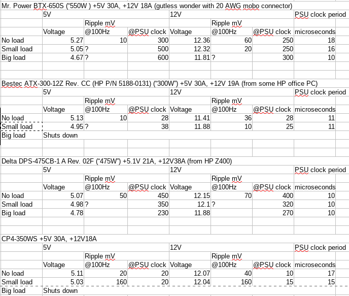

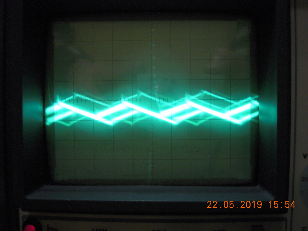

After I looked at my spare PSUs using the tester, I feel worried.
Only one of the four PSUs seems to be in-spec.

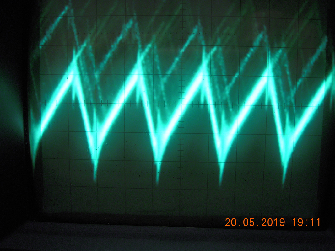

Mr. Power PSU at "small load" at 12V on the oscilloscope (50mV/cm, 5us/cm):

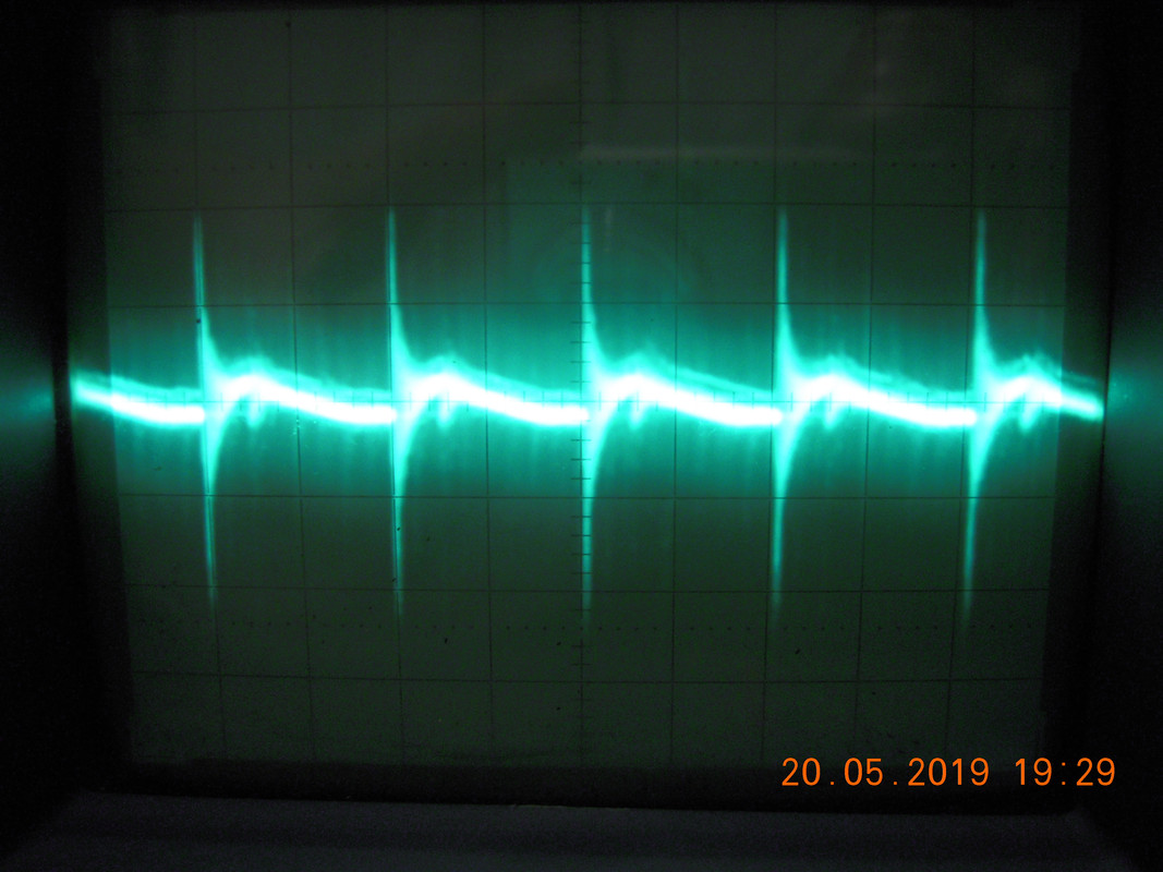

Bestec ATX-300-12Z at "small load" at 12V on the oscilloscope (5mV/cm, 5us/cm):

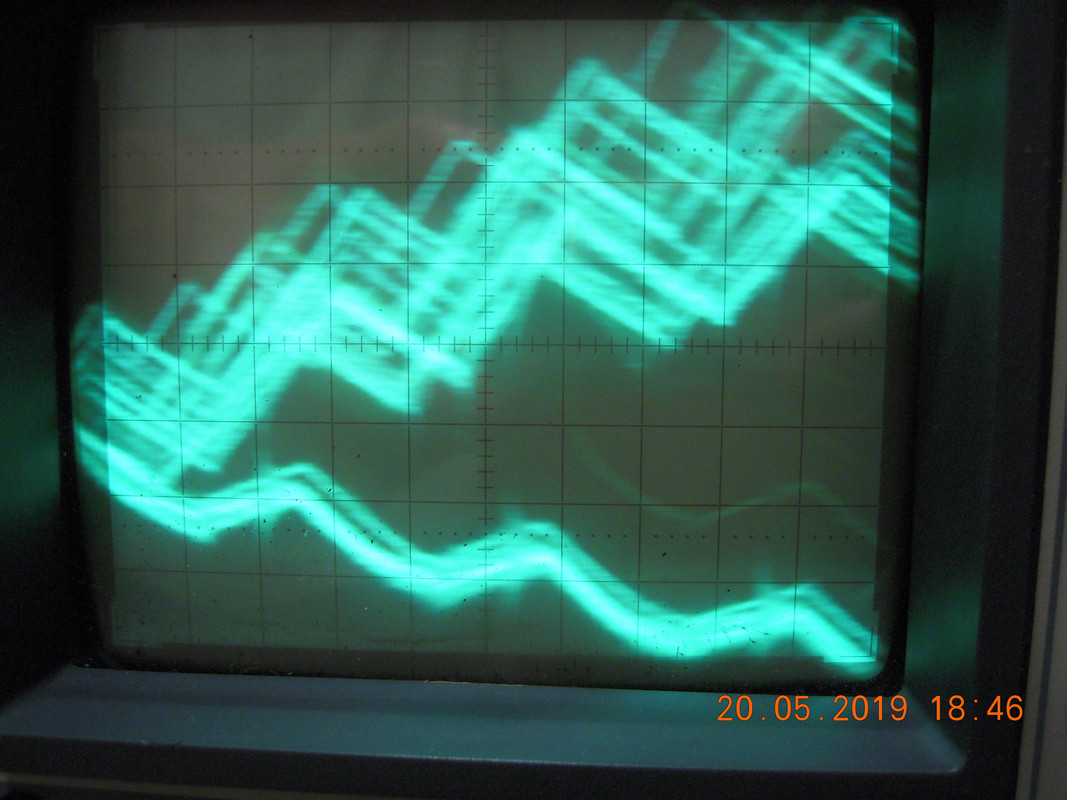

Delta DPS-475 at "small load" at 12V on the oscilloscope (50mV/cm, 5us/cm):
CP4-350WS at "small load" at 12V on the oscilloscope (10mV/cm, 5us/cm):
Now my question, can I take the following conclusions?
Mr. Power: Caps on primary weak, dead on secondary?
Bestec: Still in spec?
Delta: Caps on primary weak, dead on secondary?
CP4: Caps on primary dead?
Reply 1 of 22, by Deunan
The caps could be weak, true, but some PSUs require all the output lines to be loaded. If the PSU has 3V3 output and you are not using it, but are trying to pull a lot of power from 5V/12V lines, chances are the 3V3 is going to creep up and trip over-voltage protection in the PSU. In general properly loading PC power supplies is not as easy as it might seem. Even if it works you might get weird issues like high ripple or spikes/ringing.
High-power PSUs are typically crap at very low loads as well, even modern digital 90%+ efficiency ones. In general if the load is below 10% of the rating, anything goes (well, as long as the voltages are still within +/- 10% tolerance). Same at loads close to max but here it's usually more ripple and voltage drops, in rather predictable fashion (scales with load).
Lastly, that setup of yours... Are those 30A wires? I use 36A and 15A depending on load and the 36A are high quality and very "soft" but thick and heavy. And even on those you can easily have measurable voltage drop after a meter or two. Pulling all that power from a single molex plug will get you 0.5V drop easily. If you have to do it this way, then pull power from one connector but measure voltages on another one - as in, different cable coming out of the PSU. Preferably do both, and you'll see the actual voltage on the PSU output and at the molex end so you'll know what the wires can take. AWG rating is one thing, but many of these wires came from China and copper is expensive..

Reply 3 of 22, by retardware
Oh, I didn't think of this at all! Maybe this was the reason for the PSUs to shut down...
Will add a multimeter to watch 3.3V, too.

Reply 5 of 22, by retardware
SirNickity wrote:
Now it seems, for example on the Delta PSU, that's more peak-to-peak than RMS, and there are huge ringing spikes on the switching transitions. Seems to me like the filter caps are starting to increase in impedance and it's not damping those transients very well.
Definitely worth a better engineer's perspective, but OTOH, you really can't go wrong replacing old capacitors anyway.
Thank you, this is what I thought (from my SMPS n00b perspective).
So I will replace the caps, if only to see what the difference (if any) will be.

Reply 6 of 22, by Deunan
retardware wrote:
I found all secondary side electrolytics bloated, some even burst open.
I replaced them with some random used but good-looking low esr electrolytics I found lying around.
You need to use low-ESR caps on outputs out of switching PSUs. The lower ESR, the less ripple there will be. You can also try one notch higher capacity values but don't over do it. It's not safe for the diodes and also the energy in high-power PSU is stored in the output inductors, not the caps. So if the manufacturer cheaped out on inductors you can't really do much with the capacitors alone.

Reply 11 of 22, by retardware
Yes the question of introducing instabilities...
I now have replaced all the other caps with some new standard caps (no specially low esr).
As the local dealer had no matching 470uf mains caps there, I just took two Nippon Chemicon 270uf 450V (I think this will be sufficient for the probably not more than 60, 70W I need from the PSU).

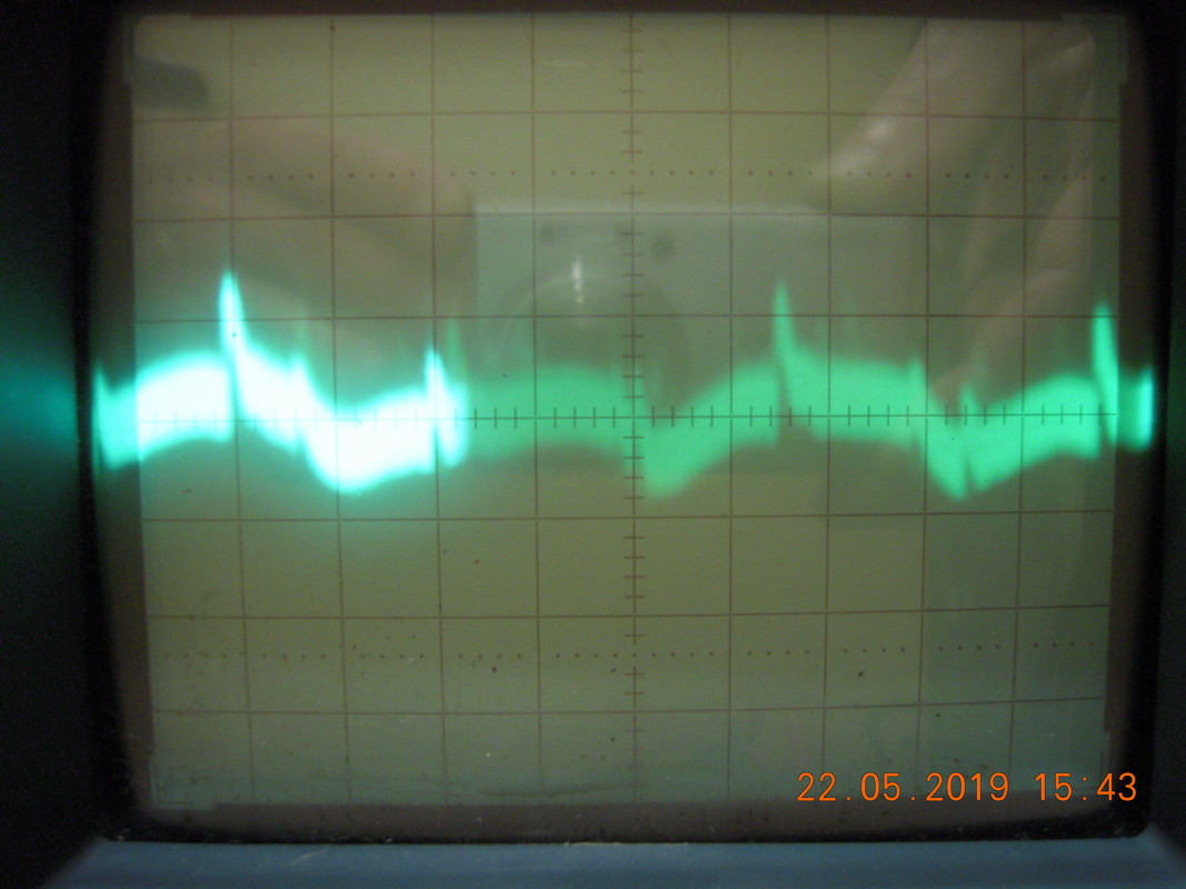

The 100Hz ripple got much better. But...
...what worries me now is what I see in the scope screen.
(I am not sure whether I just overlooked it before I replaced the caps or it is new)

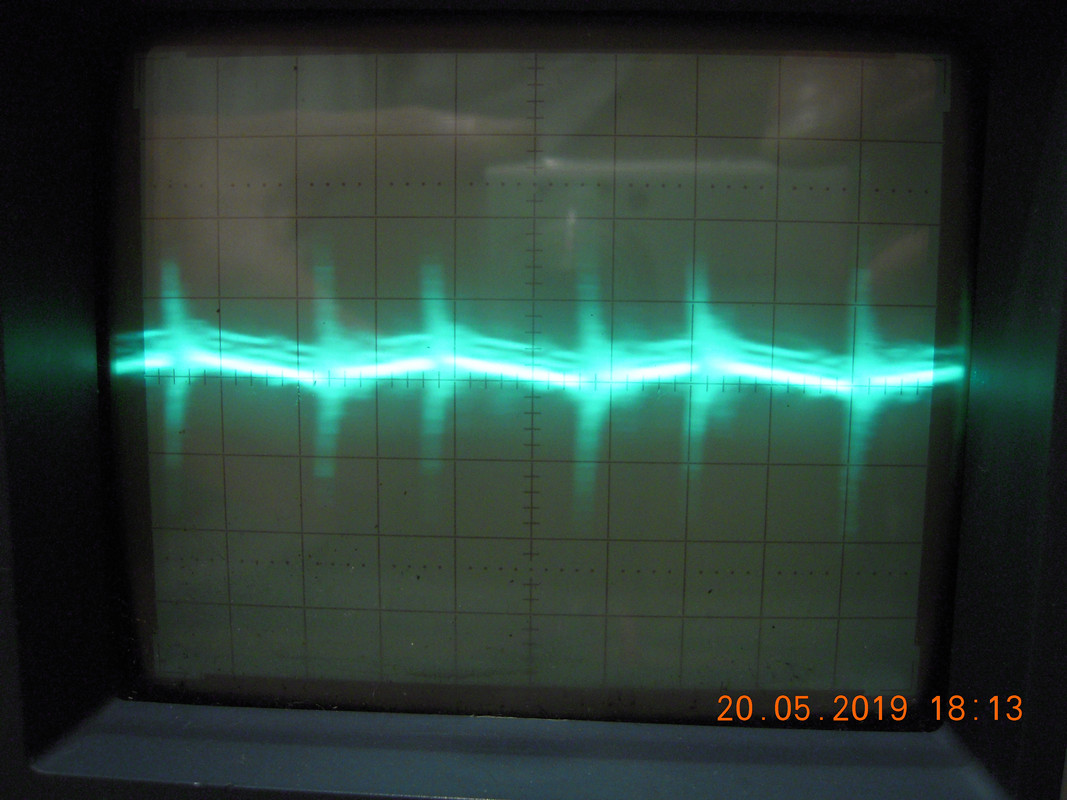

There are BIG spikes.
Following is with 5us/cm and 10mV/cm. The output ripple would be fine if it were not for these spikes.
(See in middle and left boundary of screen)
With 50ms/cm and 20mV/cm it looks like this:
(Notice the very short-term high overshooting, hard to see in the photo)
Now I am thinking about taking a separate power supply for the relais and the fans of that PSU tester.
I also have not yet made another measurement adapter to measure from another Molex cable, as Deunan suggested (still need to get more banana plugs).
Maybe these spikes are just the effects from the fans?
Or are such things just that what you meant with "instabilities"?

Reply 13 of 22, by retardware
The pics show the 12V line, and the second photo does not show that the overshooting covers the whole screen.
That's at least 160mV... the ATX specification allows 120 only.
But on the other hand, if one 5% (600mV) overshoot one microsecond maybe every 5-10 milliseconds doesn't do much damage or instability, then this PSU might be acceptable as it is now?
Reply 14 of 22, by SirNickity
What you're seeing is probably from the inductor flyback. These should be clamped, worse-case, to a diode drop by the freewheeling diodes. Did you try the ceramic bypass cap across the pins of the bulk cap? That's exactly the kind of stuff it would filter out. Particularly important if your bulk caps are not low-ESR.
Reply 15 of 22, by retardware
Thanks @SirNickity, this sounds very plausible!
Will have to get some ceramics tomorrow and add them.
I'll also check the freewheeling diodes whether they are still good.
Reply 16 of 22, by Deunan
Was this tested with at least 10% load? Without load noise in the output is usually higher for switching-mode PSUs - and that's normal.
However if you get spikes like these with pure resistive load (like the 12V bulbs you have) then either something is broken, or the PSU was crap to begin with (poor design). It's best to measure that near the load as that is where you want clean power. Sometimes even the cable from the PSU to the load is inductive enough to clean up some HF noise.
Trust me, even 50mV ripple at the load on 5V line is not an issue for logic chips. The ripple the chips themselves generate is sometimes worse, and that's exactly why TTL has such huge safety margins between 0 and 1, and why 1 starts as low as 2.4V. NMOS chips usually can't even output anything above 4V at single MHz transitions and it all still works.
To sum it up: Without load all you care is the voltages don't go beyond +/- 10%. Ripple is irrelevant unless added to the mean voltage causes it to go beyond the 10%. Spikes and ringing - same thing. Even very high spikes but short in duration carry almost no energy.
With at least 10% load the ripple should be reasonable (though that depends on the quality of the PSU) and spikes should be all but gone. 10-20mV ringing could be crappy PSU, too long cables, or just a measurement error (scope probes not 10:1, too long or badly grounded).
Oh and this is always valid: Never stick your scope probes into the primary side of a mains-powered switching-mode PSU. Unless you know very well what you are doing and why. Even then, think twice. I know this rule, I was taught this rule, I obey this rule, and yet I still made a mistake once.
Reply 17 of 22, by retardware
All the scope pictures are with 2.7A on 5V and 0.9A on 12V.
Measurements were taken directly at load point (where the resistor/bulbs connection junction from).
To make sure the fans do not factor in, I'll modify the PSU tester so that it takes the fan supply from an external PSU.
If the spikes then still are there, they must come from the PSU I am trying to fix.
Except for these big spikes the PSU seems good.
Does ringing count as "ripple" in the ATX spec? Or are there different limits for that?
