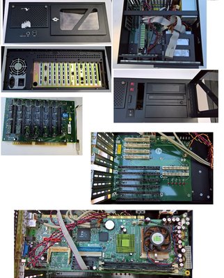

Hello
How to know that an old PC is not a server or such not normal PC ?
For example below photo of a "Pentium3 1.0B GHZ"
What is it ? A server ?

Reply 2 of 11, by luckybob
That system in that particular picture is an industrial machine. Designed to be super reliable and infinitely configurable. It is designed to run 24/7/365 in potentially harsh conditions.
It will be a system that you can play games on. It wont be fast, it will be reliable.
I'd jump on it like a fat guy after a ham. But its Finland, shipping would be out of the question.

Reply 4 of 11, by luckybob
no.
An industrial computer usually has special cards in it that monitor and control equipment. That isa card in the pic is an example. In general, an industrial computer's whole purpose in life is to control and monitor a machine(s).
That said, remove those special cards, it becomes a bog standard computer. It will run practically forever (in theory).
Reply 5 of 11, by chinny22
Why would you want to avoid them, all 3 (Servers/Workstations/Industrial PC's) are so much more interesting then a standard PC!
Generally speaking Servers are designed for 24/7 up time so have things like hot plug PSU's and HDD's that you can swap out without turning it off.
They typically support more then 1 CPU and loads of RAM, Probably not the best for a gaming rig as graphics is bottom of the priority list.
Workstations are somewhere in between a server and a standard PC. They can support 2 CPU's, load of Ram, but don't require the 24/7 uptime so you'll need to turn the thing off for hardware changes.
These can make great gaming rigs as graphics are very high on the priority list, usually they will come with the "professional" cards like Nvidia's Quadro range but you can swap them out for a gaming card.
Industrial PC as luckybob said is just a standard PC designed to live somewhere unloved and harsh like dirty factories. They often don't resemble a standard PC like your pic where the CPU sits on its own card and plugs into a backbone board, but ultimately it just a standard CPU, Chipset, etc in a different form factor.
These can be very desirable as they have more legacy connections then a standard motherboard, for instance ISA slots on a socket 775 based system for a crazy fast dos machine.
Servers usually sell for cheap (excluding shipping) as they aren't good for much else
Workstations can be had for a good price once they are obsolete
Industrial PC's are always expensive as they are specialized and somewhat purpose built and only thrown out when the big expensive industrial device its controlling is replaced which will often be 10+ years
Reply 6 of 11, by Warlord
what you need to avoid are trash boxes like gateways, emachines, and other sorts of junkboxes, be careful about hp,dell,compaq as well they are not always good. how to avoid buying a dumpster change the name to that.
Those things are called SBCs single board computers, they fit into backplanes. Thats not junk.
