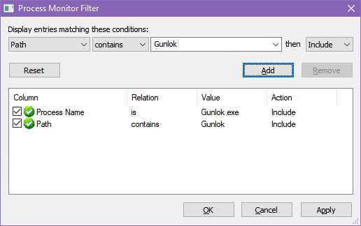

Assuming it's like the demo it's pretty easy to figure out, start Process Monitor, create a filter to sort out irrelevant things:
8.95 KiB
519 views

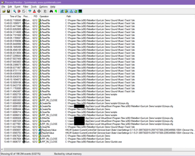

Then go to "File" and disable "Capture Events". Start the game, go to the options menu, go back to Process Monitor and enable "Capture Events", change an option then exit the game:
25.46 KiB
519 views
Should be fairly simple to figure out from here right? I mean there's only one file that gets written, it's virtualized on the computer I tested on, but it's GameDirectory\scripts\GLkeys.cfg , for the demo at least.
