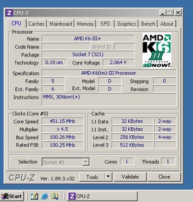

Reply 40 of 453, by 1541
As you also requested 686 CPUs, I'd like to throw a K6-III+ in the ring...
The mainboards own L2 cache is correctly identlfied as L3 cache with the K6 CPU
The spec only misses the "Code Name" for the K6-III aka "Sharptooth" aka "AuthenticAMD Family 5 Model 13"
