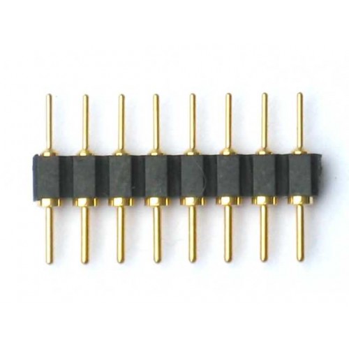

look up machine pin headers (round). can get different kinds. eg: these are not the fat square pins that dont fit in all pth.
Yeah those are pretty much what the castellated version is meant for. It uses those headers 'stub side up' and the castellations are made wider to fit right around the wider cylindrical part of the pins. Of course, the non-castellated version will work just as well with those. 😁
