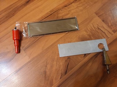

SpectriaForce, have a look at the photo below.
The alloy piece is from a hardware store, aluminium flat bar, 40mm by as much as you need long, by 3mm thick. Cut it to 15.4mm and remove the burrs. I guesstimated where the keyboard hole goes, even when I measure it, I still get it off by a few mm's. I use 6mm drill bit to pilot the hole then get it to 22mm with the special bit. Works great and doesn't leave any burrs. As for the bracket (blank i/o plate on eBay), I use a 22mm hole saw and finish it off with a round file. Scuff the surfaces where the glue will go, leave it in the vice for a day for it to cure. Originally, the alloy piece was for safety, then I noticed it actually looked really nice.
I should make a video one day...

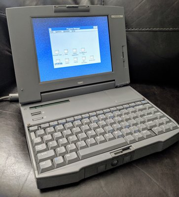

Most of my work has been on the NEC Versa 40EC 486 DX2-40 laptop.
What's done
- hinge fixed with JB Weld and working great, the J.B. weld matches the case a bit
- autopsy before wipe showed it belonged to a Ford engineer....that's awesome, I love my 90s Ford...so only fitting I have a "Ford" laptop too. Might need a classy blue Oval, 🤣.
- wiped ALL data off per my own ethics, original 250MB HDD is in amazing shape, no bad sectors. Still running the original OS like ad though - MS-DOS 6.22 and Windows 3.1 for NEC Devices....but reset to a "clean" state and tuned for my own electronic engineering on guitar pedals and maybe Amps with Circuitmaker 6.1.
- game Dev apps added (GameMaker, AGS, Graf-X II, CIA)
- only my favorite games installed (Monkey Island 1&2, Ultima 6, Tank Wars, Mario & Luigi, Microlink Yahtzee, Wolfenstein 3d, and sharedata Game Show games + NESticle and some choice RPGs).
- Ultima 6 got corrupted during transfer using mTCP FTP ( probably have something wrong in the config file) using my 486 desktop and a 44 pin to 40 pin IDE adapter. So I "spoon fed" the entire working install from my 486 DTs SSD to the laptop...works great.
Things to do...
- new CR2430 CMOS battery
- new suspend battery
- new main battery + rebuild old
- PCMCIA wifi (Orinoco gold I think)
- wfwg 311 upgrade
- 8GB SSD upgrade for upgraded config and reliability in the future
A pic as it is now....

Very cool looking machine!
How's the trackball? I like me a built-in trackball, but the one on my Siemens PCD-4ND tends to clog up with dust and grime pretty quickly and needs cleaning pretty much every couple hours. I use one of those old Logitech Trackman clip-ons (https://i.imgur.com/MQh86oz.jpg not my picture) which works pretty well.

The trackball is pretty good. It rolls on two steel bearings and 2 rubber balls. The cover snaps off and is fairly easy to clean. The rubber balls on the encoder shafts sometimes need realigned for optimum tracking but if that's set just right it works pretty well. Also, being on the front, it makes it easy to use laying down.
