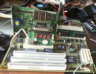

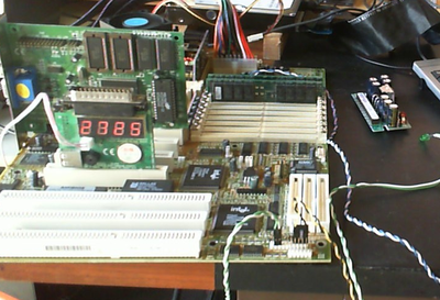

Hi Guys, I just found a P6FX2-A motherboard (http://www.ecs.com.tw/ECSWebSite/Product/Prod … -RR-/Socket%208) in a box and wondered if it worked.
It fails to post with the AMI BIOS giving post error 27 with 25 being the last thing that worked. Does anyone have any idea what the issue might be and how to fix it please? I have tried different SIMMs, SIMMs in the other two end slots, a different GPU and still get the same error 😢

Reply 1 of 8, by DankEngihn
What BIOS revision is it?
AMI 2.2 bios, it represents "base 64 memory tested"
AMI Color, "Video mode tested"
AMI Win BIOS, "Initialize before setting video mode"
AMI ez-flex BIOS, "Perform setups for vector table initialization"
We need more information about the bios.
Reply 2 of 8, by red-ray
Thank you for your reply and how can I get the information you need?
The AMIBIOS chip says 686 BIOS (C) 1995 AA00266606 and searching fx2a12db.bin I found AMIBIOSC0622 + American Megatrends, Inc.0620 07/15/95 EliteGroup Computer System CO.,LTD. P6FX2-A Rev. B
The codes I spotted are d1 d3 d6 d7 05 06 0E 0F 25 27, does this help?
Looking @ http://www.bioscentral.com/postcodes/amibios.htm I think it may be AMI Win BIOS as it's the only one with d1
Reply 3 of 8, by DankEngihn
D1 Check for <INS> key command
D3 Chipset initialization/auto detect memory
There's no D6 or D7
05 Disable cache
06 Uncompressed POST code
0E Initialize after KB controller batch
0F Write KB command byte
25 Read input port of 9042 chip, clear password
27 Initialize before setting video mode
It looks like it's getting caught up on something right before it initializes the display adapter.
Have you tried using an ISA video card?

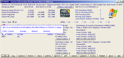

I got an Orchid Kelvin 64 ISA and tried with that, but no change and it's still stuck @ post error 27 + 25
I know the Kelvin 64 is OK as I checked it out in my Gigabyte GA-686DX system.
