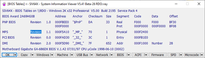

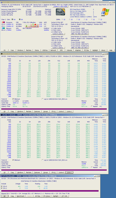

I have had a Gigabyte GA-686DX with 2 x Intel Pentium II Overdrive (Deschutes) running NT 4.00 + NT 3.10 for many years and today I decided to install W2K on it and make it triple boot. I how have W2K running, but CPU-1 is very slow and it looks like the caches are disabled. I don't think it's a BIOS issue as when I boot NT 4.00 both CPUs run at the same speed.
Has anyone seen similar and/or know how to fix W2K please? I have Googled to no avail.
Below you can see all the system details and that the caches seem to be disabled on CPU-1 😢

    SIV Cache Latency panels

Reply 3 of 9, by red-ray

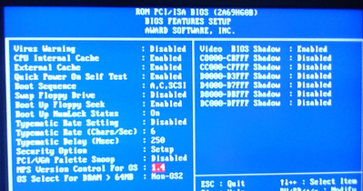

I suspect I have figured out the issue with the cache being disabled on CPU-1. In the BIOS I selected MPS 1.4, but all of NT 4.00 + W2K + WXP report it as MPS 1.1 !
Given this there must be something wonky in the way the BIOS is setting things up, so I suspect I will need a fixed BIOS. I wonder if I can get one 😉
I don't know why NT 4.00 is OK, maybe it has MPS 1.1 support and W2K and later don't.

Reply 4 of 9, by 1541
Have a look at: https://www.techarp.com/bios-guide/mps-control-version-os/
Microsoft Windows NT onwards already supports MPS 1.4. Therefore, all newer operating systems like Windows 2000 and Windows XP and beyond have no problem supporting MPS 1.4.
Dan Isaacs reported that when you set the MPS version to 1.4 in the ABIT BP6, Windows 2000 will not use the second processor. So, if you encounter this problem, set the MPS Version Control For OS to 1.1.
There seem to be verious issues around MPS...

Reply 5 of 9, by red-ray
1541 wrote:
Thank you for the link which I had already read, but as I specified the issue is that when I select MPS 1.4 in the BIOS either the BIOS still sets MPS 1.1 and/or W2K + WXP think it's MPS 1.1.

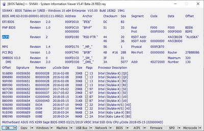

Below is what get's reported when ACPI is present, also note it's also MPS 1.4 and has EFI/UEFI support.
If it was a simple as setting up Windows I suspect I would have resolved this myself, but currently expect I need a fix to the BIOS, but doubt I could get Gigabyte to fix it for such an old motherboard.
file.php?id=68187
If you are confused by the ASUS WS X299 Sage BIOS 0905 03/21/2019 when the 0905 BIOS was released in January it's because I got a special BIOS from ASUS to resolve issues with running VROC RAID + SATA RAID at the same time.

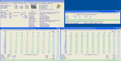

I never found a solution to the CPU-1 cache being disabled so felt I would bump this thread and hope. Below you can see I also get the issue on WXP.
file.php?id=94431
    108.51 KiB
    590 views
    CPU-1 Cache is Disabled
