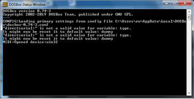

Reply 351 of 353, by psyklik
Looking forward to some assistance in getting the serial ports working in DOSBox.
I have set up the DOSBox config for serial ports as instructed with the following.
serial1=directserial: realport:COM1
serial2=directserial: realport:COM2
Yet, I get the following message upon running DOSBOX for both instructions.
"directserial:" is not a valid value for varible: type.
I am working version 0.74-3
Please review attached screenshot.
Any help will be greatly appreciated,
    61.57 KiB
    7120 views
    screenshot of error
Reply 353 of 353, by psyklik
Thanks much for your advice. I now have DOSBox Com2 working and the CompuSail program working as well. I apologize for my tardy response as I had shelved the project till this week. Now that my sailing season is past for the year I returned to the project. By the way, my system is Win7,64 bit.
