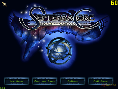

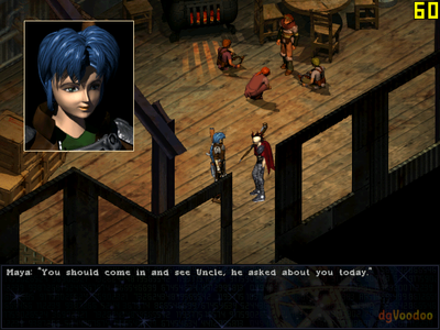

Perhaps you might be able to use Application Compatibility Toolkit to see what the actual fixes Windows is applying are. On Windows 7, I do indeed have a built-in compatibility setting for Septerra Core.
It applied the fix "Virtual Registry" to the files "Launch.exe", "Monolith.db", "Septerra.db", and "Septerra.exe".
These fixes don't prevent Septerra Core from running with dgVoodoo on Win 7, as you can see. These shots were with 2.62_1, but the game also works with 2.53/2.54.
