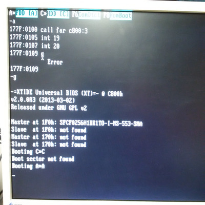

Reply 52 of 80, by BlackLinus24
I found some time and managed to do what you first suggested.
Put back the original BIOS and typed the command lines (please see screenshot attached).

Reply 53 of 80, by Predator99
You are right, file seems to be damged during upload...here again
patched2.rar
36.33 KiB
19 downloads
Output looks perfect, everything works.
