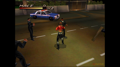

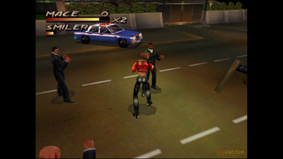

Fighting Force needs: […]
  • XP patch (here)
  • dgVoodoo
  • Winplay DLL patch (here)
  • DxWnd (only for CDDA playback, needs to be a very recent version)
I would definitely call it a problematic game, but it should be playable now (thanks to DxWnd's recent CDDA improvements).
Thanks for the help!
DgVoodoo works but there are some visual glitches. With the DDrawCompat wrapper I am getting glitch-free visuals.
With the exception of joysticks not working (which can be worked around with JoyToKey) the game works just fine now. 😀

IlhanK wrote on 2020-01-28, 20:37:
Thanks for the help! DgVoodoo works but there are some visual glitches. With the DDrawCompat wrapper I am getting glitch-free vi […]
ZellSF wrote on 2020-01-27, 18:47:
  • XP patch (here)
  • dgVoodoo
What sort of visual glitches? Dege might be interested.

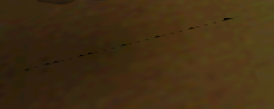

Reply 70 of 303, by IlhanK
ZellSF wrote on 2020-01-28, 21:06:
Black lines glitch in and out on the asphalt textures.
Reply 71 of 303, by ZellSF
IlhanK wrote on 2020-01-29, 16:29:
That's interesting, I don't get those.
1) Are you using the "XP patch" linked earlier?
2) Which GPU do you have and which driver version?

Reply 72 of 303, by IlhanK
ZellSF wrote on 2020-01-31, 11:44:
Yeah I'm using the XP patch. GPU is RX 580 with the current Adrenalin 20.1.4
