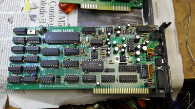

Desoldered old TEA2025, put in socket, put in new TEA2025. Still the same 🙁 Some curses followed, intense staring at the Snark Barkers design at GitHub.
And then remembering the words of a wise average man:
Cyrix200+ wrote on 2020-02-03, 08:50:
... the only spares I have are from the same dubious cheap eBay batch ...
Soooooo replaced the TEA2025 again and: it works fine again!
Never trust the cheapest IC's you can find on eBay . I wonder how long this one will last 😁

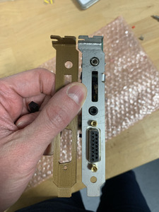

Prototype stainless steel bracket. I will have enough of these prototypes soon for the people who ordered their PCBs with me. I will send out emails. The prototype has ONE error though: the leg which attaches to the hole below the volume wheel is misplaced by 3mm. So the bracket will hold in place ONLY by the DB15 connector, which is fine, I think. I will have an adjustment and publish the DXF for people to make their own brackets. But I CANNOT produce more brackets, most probably without considerable cost. Not sure how much demand there would be anyway...
1.12 MiB
1296 views
1.44 MiB
1296 views

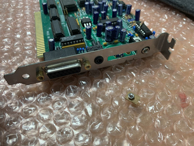

Well first of all, thanks to the fine guys at Tube Time that have retro engineered the Sound Blaster, they did a meticulous job, all those schematics, the PCB replica free to print..
Back in September/October i sent the gerber files to Jlcpcb, didn't spend too much for the minimum order of 5 cards.
Started ordering lots of different IC's from China probably including many 'fakes'. (Old chips sanded and rebranded) But oh boy they were so cheap, and i have enough to make 4 more cards.
Scrounged some components from old cards.
Decided to put sockets to every chip, to test and replace potential faulty ones.
Here it is
276.8 KiB
1256 views
Well the good news is it fully works, even with all shady components imported from China. Had no issues with programming the microcontroller on the card.
Here i am testing the microphone input with a famous (at least for me) parrot.
104.31 KiB
1256 views
I 3d printed the bracket using Thermalwrong files. Had to adapt it to my out of standard Jacks, very nice tho.
Bad news i didn't find the original potentiometer for cheap, i did use another (working really fine). I'll replace it in the future,or glue a new wheel on it.
Midi sound is excellent, digital audio works fine.
I did even try the SAA1099 with Monkey island and it works. Really interesting sound.

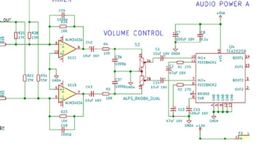

What is the easiest way to completely bypass the potentiometer and set it to something around a fixed 70% amplification?
Reply 257 of 497, by mongaccio
appiah4 wrote on 2020-02-28, 07:30:

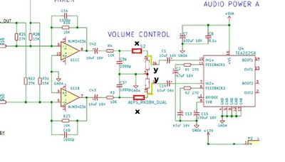

First of all , i'm Just an hobbyist in electronics, so take all this with a grain of salt.
Well it is more complicated than i thought, as you can see the pot is put before the amplifier, with grounding and capacitors all around.
61.28 KiB
1215 views
My 2 cents of reasoning. As far as i can see here must be 10 kohm between ground and the origin of the signal .
so you need 2 different resistors for each line 4 resistors in total,x and y. Let's say x is 3.3 kohm and y is 6.7 kohm
X+y must be 10kohm, and you take the signal between these 2.
63.11 KiB
1215 views
If someone with a degree in electronics can confirm this is right , that would be much appreciated
Reply 258 of 497, by Benedikt
The choice of the two resistors for each voltage divider would also have to take into account whether the volume pots are linear or logarithmic, i.e. whether the goal is 70% of the input voltage or 70% perceived volume.
Reply 259 of 497, by root42
Benedikt wrote on 2020-02-29, 08:19:
You could try both variants by using a potentiometer and tuning it to the desired volume (either linear or logarithmic). Then you can fix it with a drop of loctite. Thereby avoiding all the redesign. 😀
